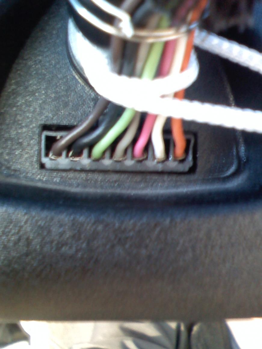

Old Nov 14, 2011 | 03:34 PM
  #27
Joined: May 2011
From: Newfoundland, Canada
Here's the picture. I pulled back my a pillar covers, and the only wires running down there was the one for my remote start antenna. I guess the wires for the mirror go back along the roof.

Grey red and white it is. You have auto dim as well right? Not sure when OnStar left the car phone and went to the mirrors.
Black and grey runs from bcm but looks like the rear OSHI handles might have the wires going to the mirror. White doesn't touch the mirror in the book but it's labeled theater dim 1 and grey is dim 2. Green is theater dim ground.
