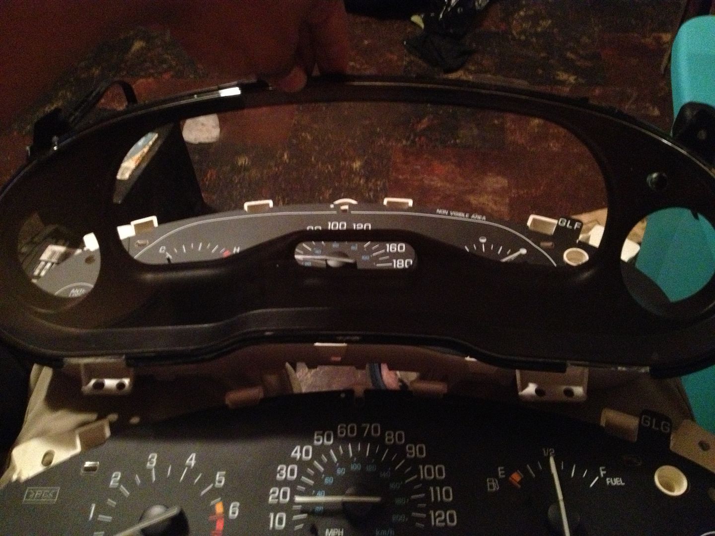

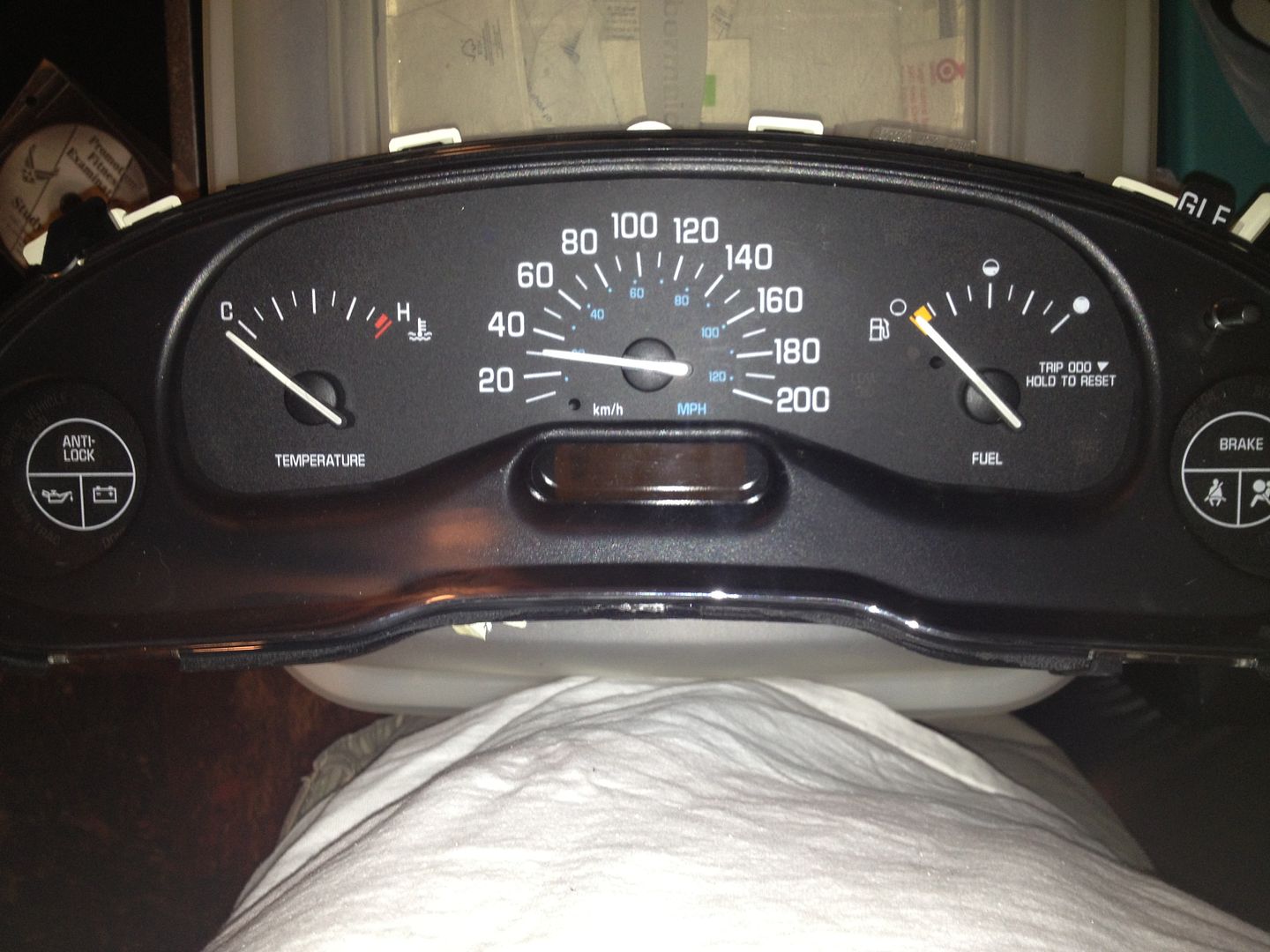

At the end of the day I can at least use the overlays the regal uses vs the plain ones the century has.

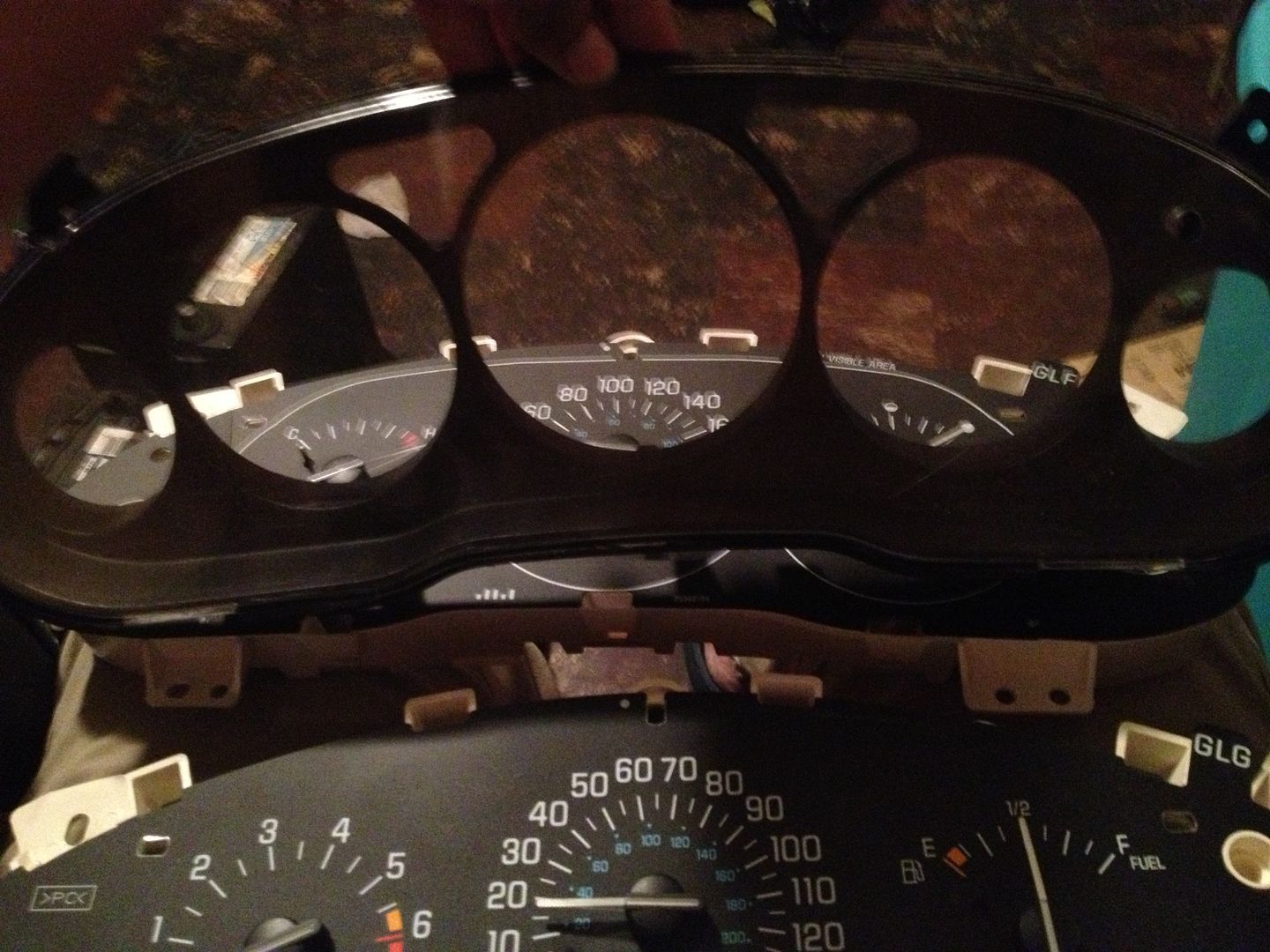

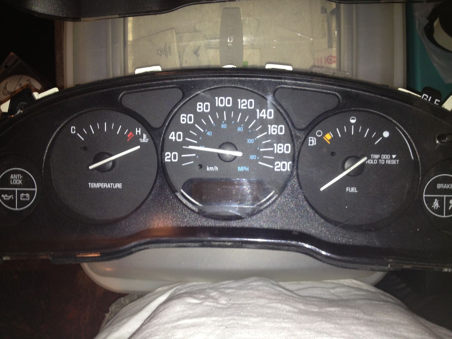

*Just an idea floating around not concrete* Debating on swaping out needles from diffrent cars and maybe painting/vynal wraping the shrouds.
Century plain shroud on Century gauge cluster
http://i90.photobucket.com/albums/k2...ps6d5baa51.jpg
Regal 5 circle shroud on Century guage cluster
http://i90.photobucket.com/albums/k2...ps7ea0b0eb.jpg
In case you aren't seeing the difrence here is another angle w/o gauge faces
http://i90.photobucket.com/albums/k2...ps7e872e57.jpg
Regal
http://i90.photobucket.com/albums/k2...ps4f4a03e8.jpg
Both faces
Century top Regal bottom(white line is normally hidden by shroud and the ends are cut because I toook the ends for a previous project)
http://i90.photobucket.com/albums/k2...ps96fd88a2.jpg

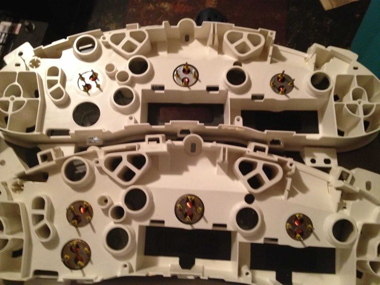

Both backs
Top Century Bottom Regal. As you can see all gauge clusters had a slot for 4 needles and Driver Information Center.
http://i90.photobucket.com/albums/k2...psb24afced.jpg

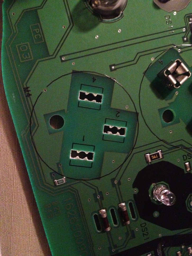

This is the spot where the 4th needle on the regal would be controlled. the Century board doesn't have the clips that you see to the right for the gas needle. Not sure if soldering those pieces would unlock that feature. Regal gauges came w/o the board plus using the one in the car already keeps the original miles.
http://i90.photobucket.com/albums/k2...ps3454da8f.jpg

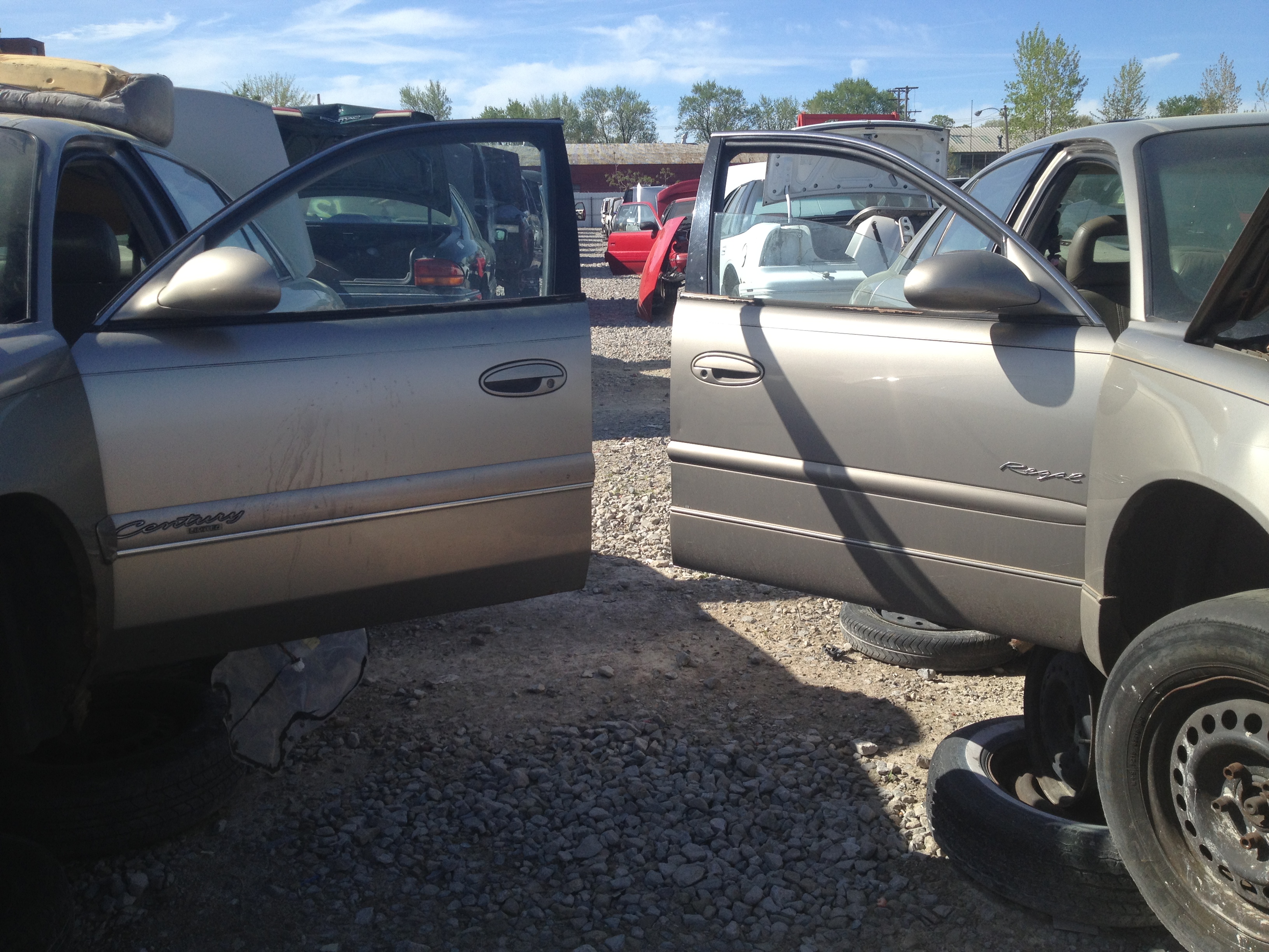

One more post to add is difrence between regal and century doors is this....
Plastic panels on the bottom to square it out. Might do this if I find the right color front and rear end. Sems like no regal w/o front end damage on and off the road exist.

Trunk brake lights and cluster sans board were 1999 Regal LS pictured above in the door comparison pic. With my board the fuel and speedo worked. Tach malfunctioned due to the resistors and a 4th connection missing from the board. Temp not work missing resistors and 3 connectors.
Took the overlay and put it on the Century one for now. So far the mods were Canadian ABS and Brake lights and regal 5 rings.

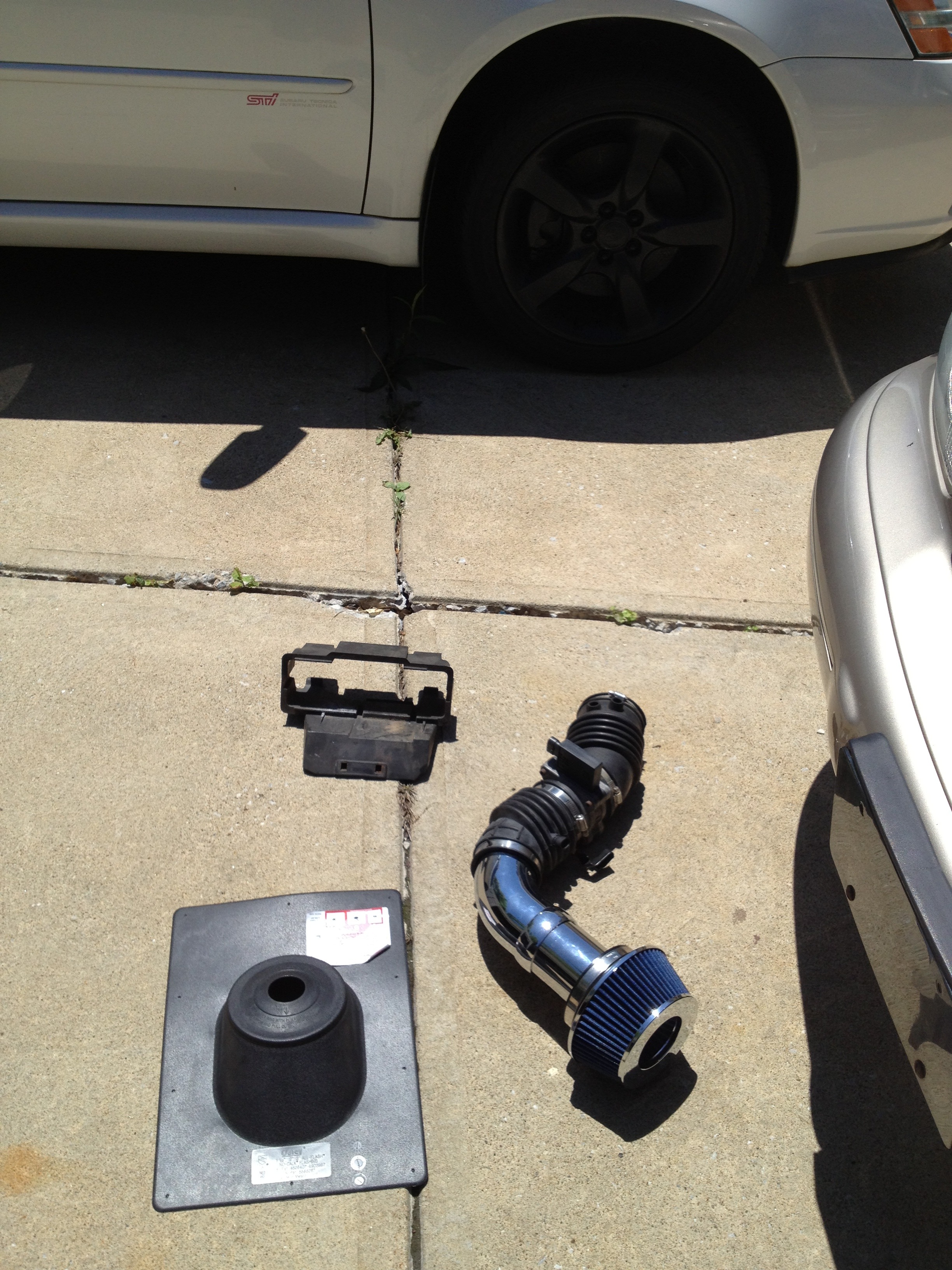

Sneak peak at next mod

Interesting intake setup. Is that filter going to be big enough?
What are the other two pieces?

F Body ECU bracket and vent pipe flashing if I need to put the filter out of the engine bay. I installed it temporarily with the most of the media taped up and only the top open. I may cover the filter and only leave the top open to the fender.
