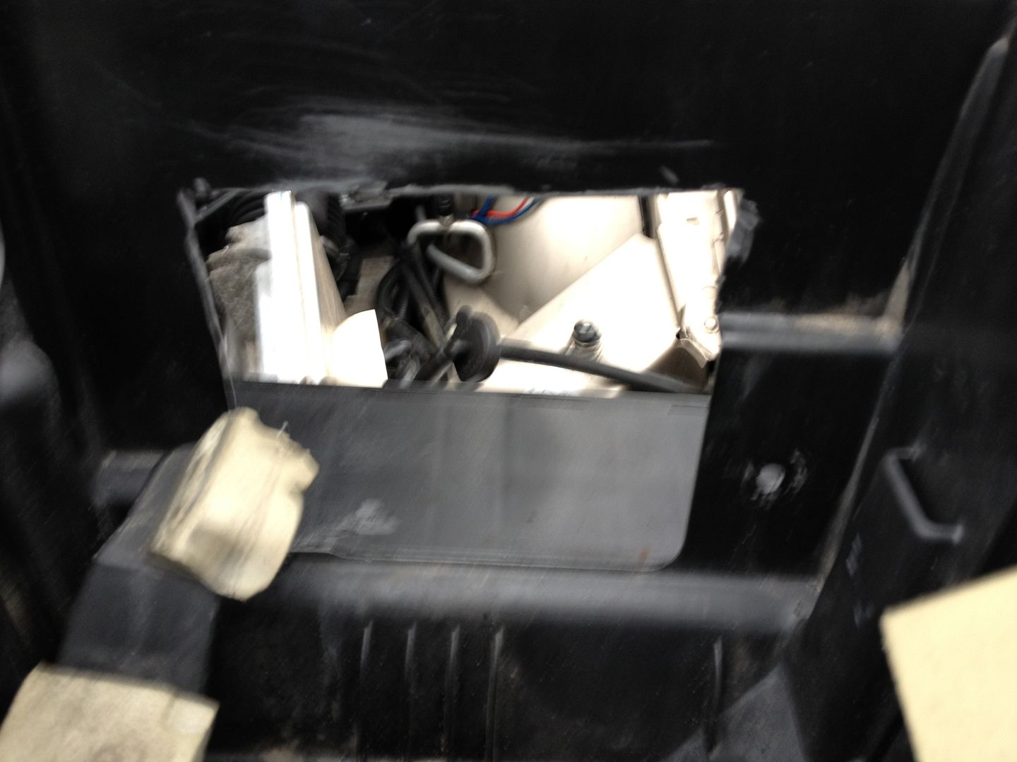

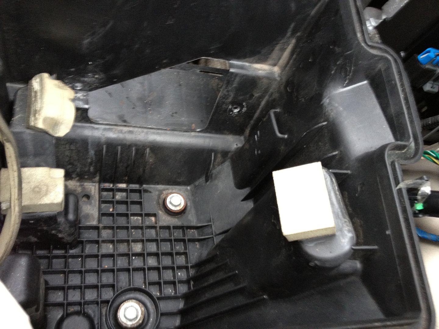

Here is the box with ECU removed. You can see the somewhat lip that holds water. In the LG8 box, the air enters the top half of the box. Hope nobody plans on fording a river in their W body granted I seen 26 inch wheels kinda fit the Century with "some modification" on YouTube.

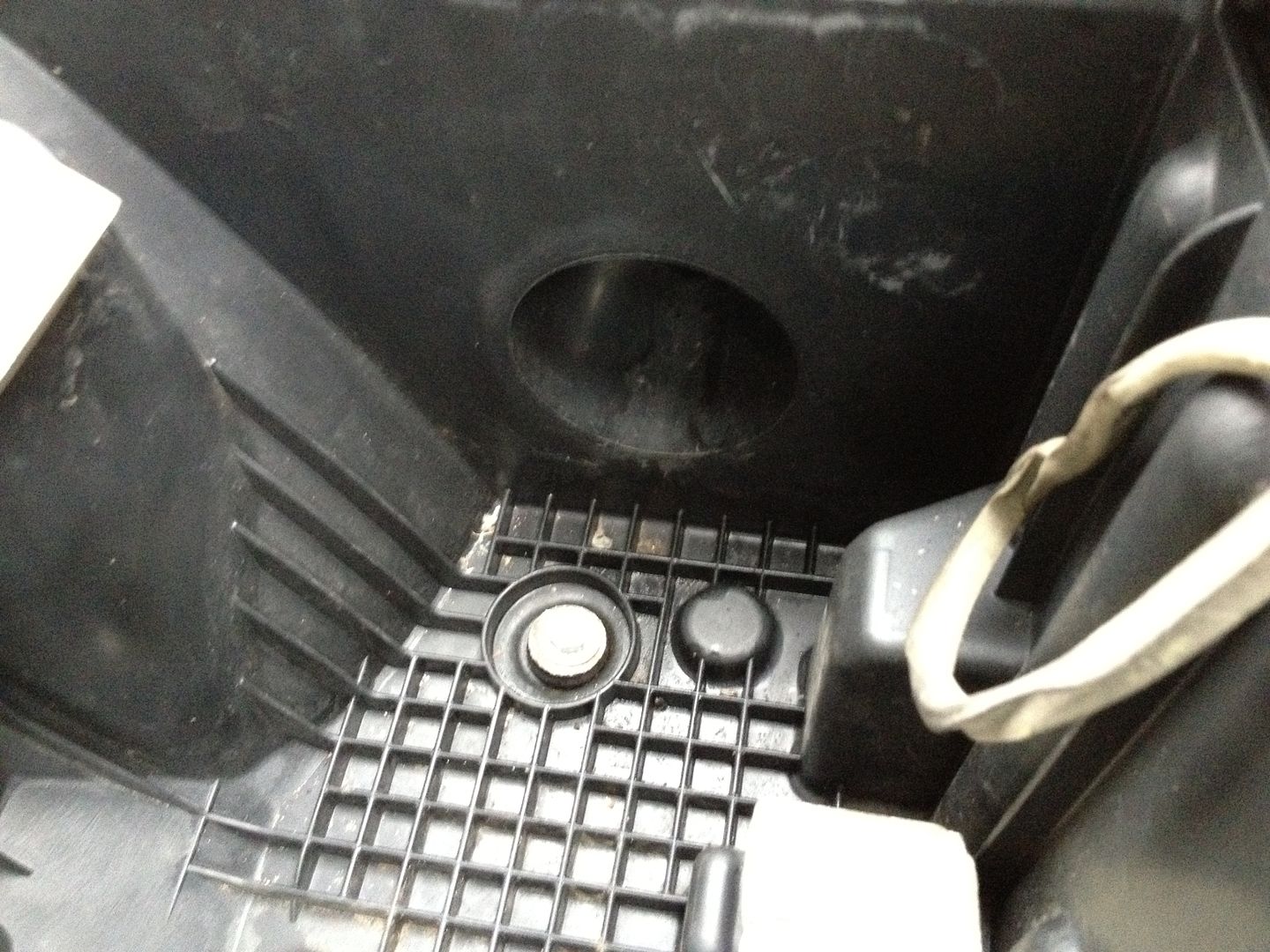

Here is the opening where I removed that bottle neck snorkel from my 98 air box flowchart thread. I could have placed the snorkel back to show where it was in relation but it's a day late and a dollar short now.
http://i90.photobucket.com/albums/k2...6/7f62a919.jpg
This next one is the hole where the box breathes from the fender just above the tire(the next bottleneck). The Regal guys run their CAI filters this way. Grand Am guys aren't as lucky cause they have a fender brace here.
http://i90.photobucket.com/albums/k2...6/e914ff4d.jpg
Here is the new big gaping hole in the air box. I went back in later and smoothed the edges out some. The angle that wall is at made cutting a traditional square hole almost impossible.
http://i90.photobucket.com/albums/k2...6/218f1a0c.jpg

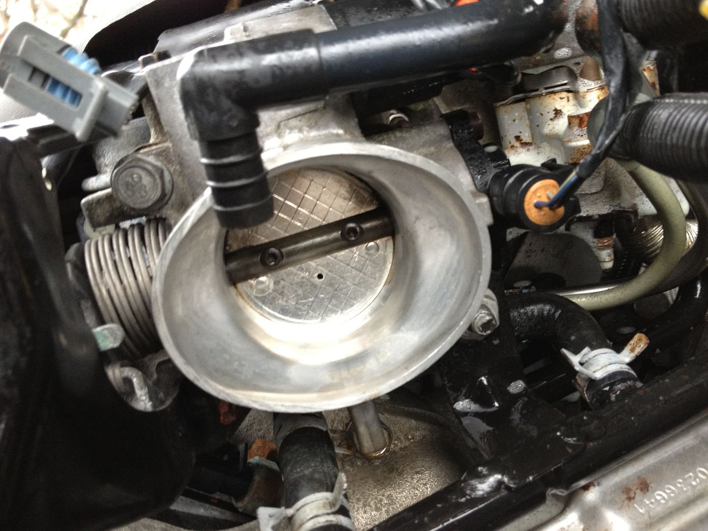

Since I was there, I went and cleaned the throttle up some. Started to rain so I didn't do the LA1 throttle body swap.
http://i90.photobucket.com/albums/k2...6/be4a39e8.jpg

The LA1 throttle body is a direct swap for your car. I have to cut my factory linkage to get the TB plate to fit.
http://60degreev6.com/forum/showthre...dy-Walkthrough
