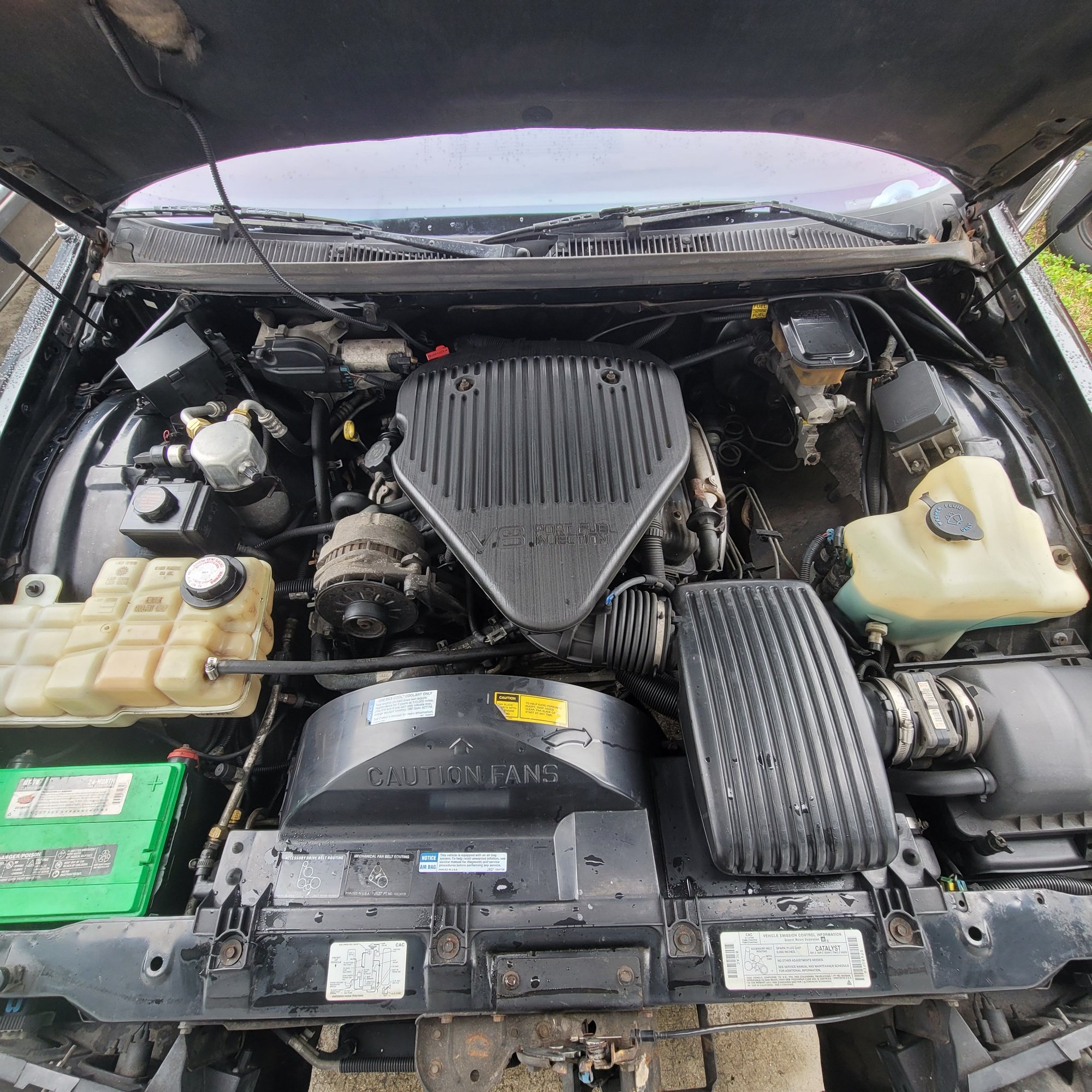

I've since added another full gallon of Dexcool. (didnt know about bleeder screws to bleed the air and still havent). It does seem to have some leakage around some hoses. I checked the oil which was full and there was no evidence of coolant in the oil. I then drained the oil, replaced filter and refilled with fresh 10w30. The old oil was pitch black. Just horrific. Again there was no evidence of coolant in the drain oil either.
The temperature gage does not work at all. It stays at the cold position. It only pegs right during start position.
My plan is to replace the stat, fix the gage, replace leaking hoses and hope its not the waterpump (and collateral damage opti spark), then do a combustion gas test on the coolant. The exhaust was normal and invisible on the way home (no smoke or steam of any kind) but starting it up yesterday it looked awfully steamy, much more than i remember a car is supposed to do.
I might just be on edge and paranoid based on circumstantial evidence but hopefully this deal wasn't too good to be true. It's possible there was just a lot of condensation in the cold metal exhaust system from the humid overnight air. When i started it up, immediately copious amounts of clear pure water dripped out of the exhaust pipes and as it warmed up it began to vaporize. After a minute there was quite a bit of steam. Not knowing if it was normal or not, I shut it off at this point so i dont know if it would have gone away or if its coolant seeping into the combustion chamber. Still no coolant in the oil though.
Could the iron heads of the RMW LT1 have survived this abuse? I heard that its rare that they ever blow on the iron heads. I hope thats true. No coolant in oil so that's comforting but not conclusive.

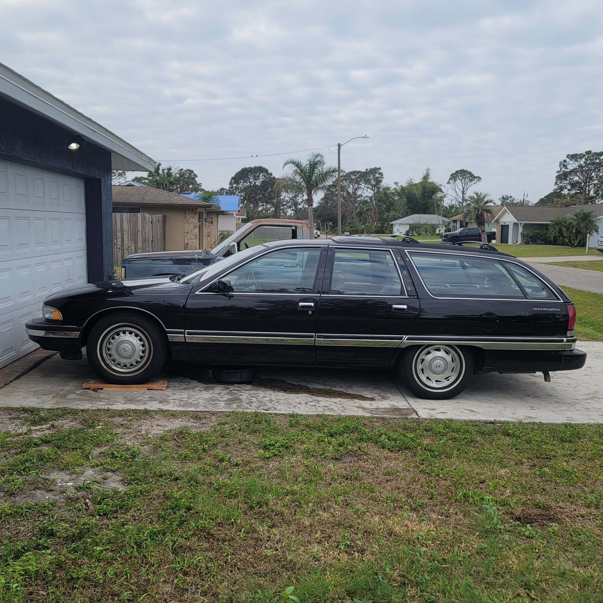

Note mismatched rear wheel? Not sure what thats off of or why.
Note mismatched rear wheel? Not sure what thats off of or why. That's fresh engine oil that leaked after oil change due to oil filter not being tight enough. Its not coolant.

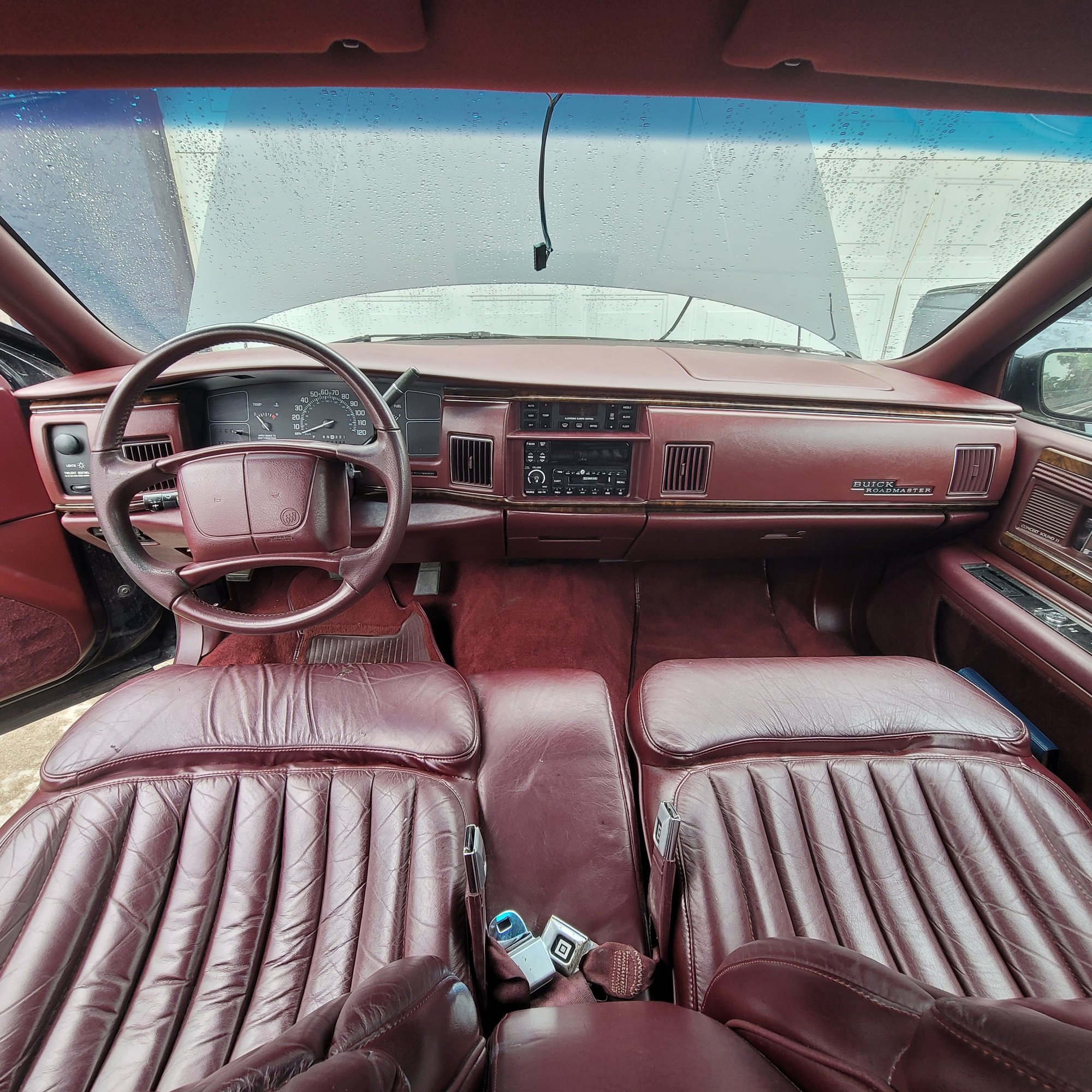

Pretty much mint.
Pretty much mint.
