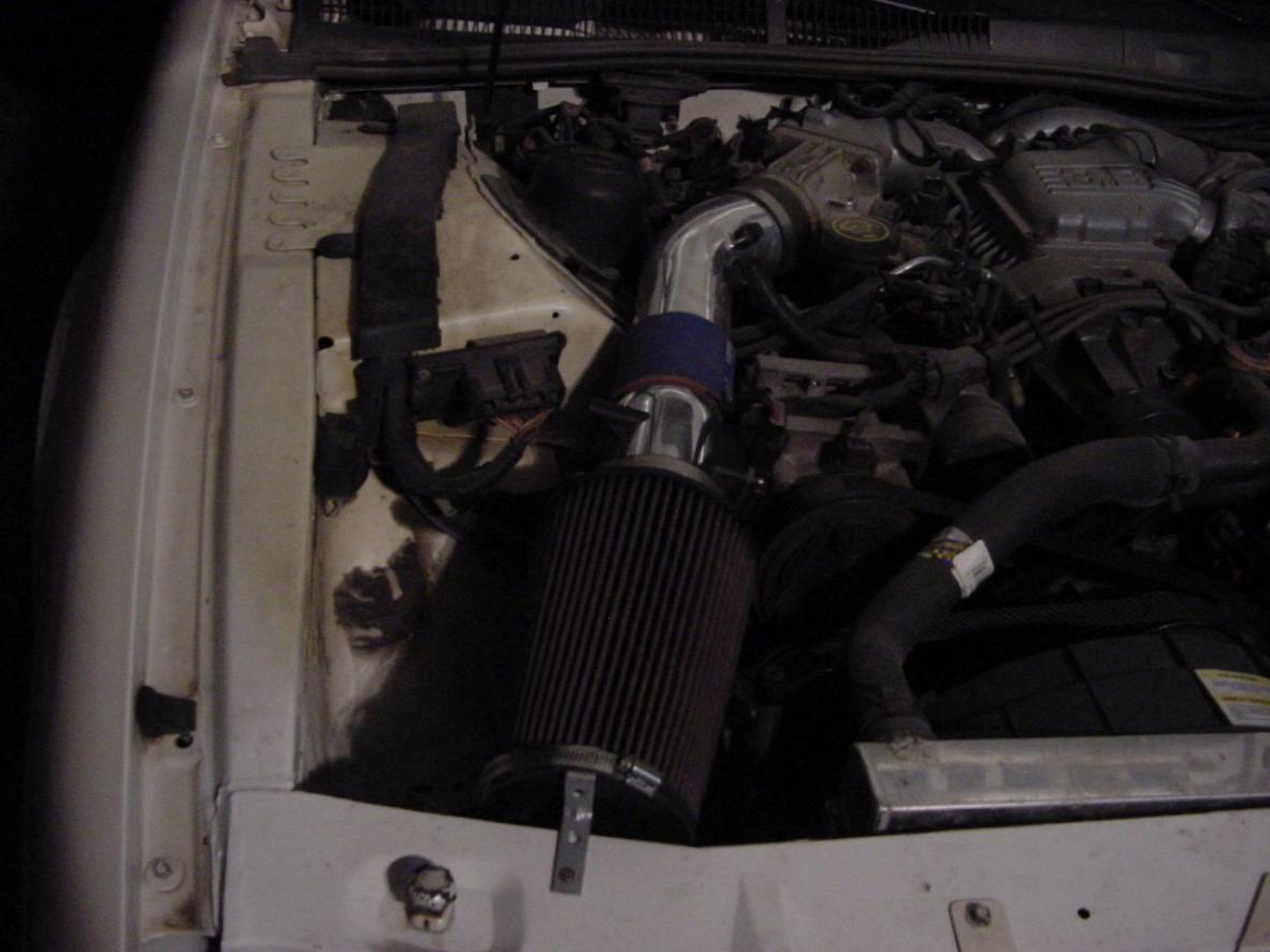

The supercharged Regal came out with the 3800 series II engine in 1997.
http://en.wikipedia.org/wiki/Buick_Regal
The easiest and safest way to do it is put a for sale sign in the window and buy a supercharged Regal.
On any engine it's more than just unbolting your intake and bolting in a superchargers intake and supercharger. There is the drive, the intake, all the different sensors and all the wiring to operate an engine that has both vacuum and boost, the SC computer, bigger fuel injectors, maybe a bigger fuel pump.
The kit can be found here: http://shop.zzperformance.com/3800-s...sion-kits.aspx
Search around some and see if you can find someones build thread who has done it before you think about it too much.
I have a turbo Volvo and a supercharged Thunderbird so I know what I'm talking about. The SuperCoupe uses the same Eaton M90 blower the GMs do.
http://buickforums.com/forums/showthread.php?p=165482
http://www.buickforums.com/forums/sh...ad.php?p=25500
