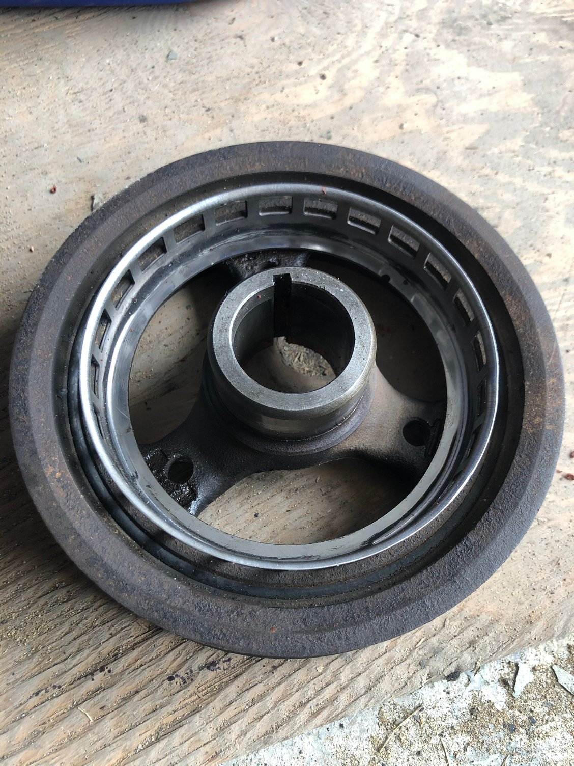

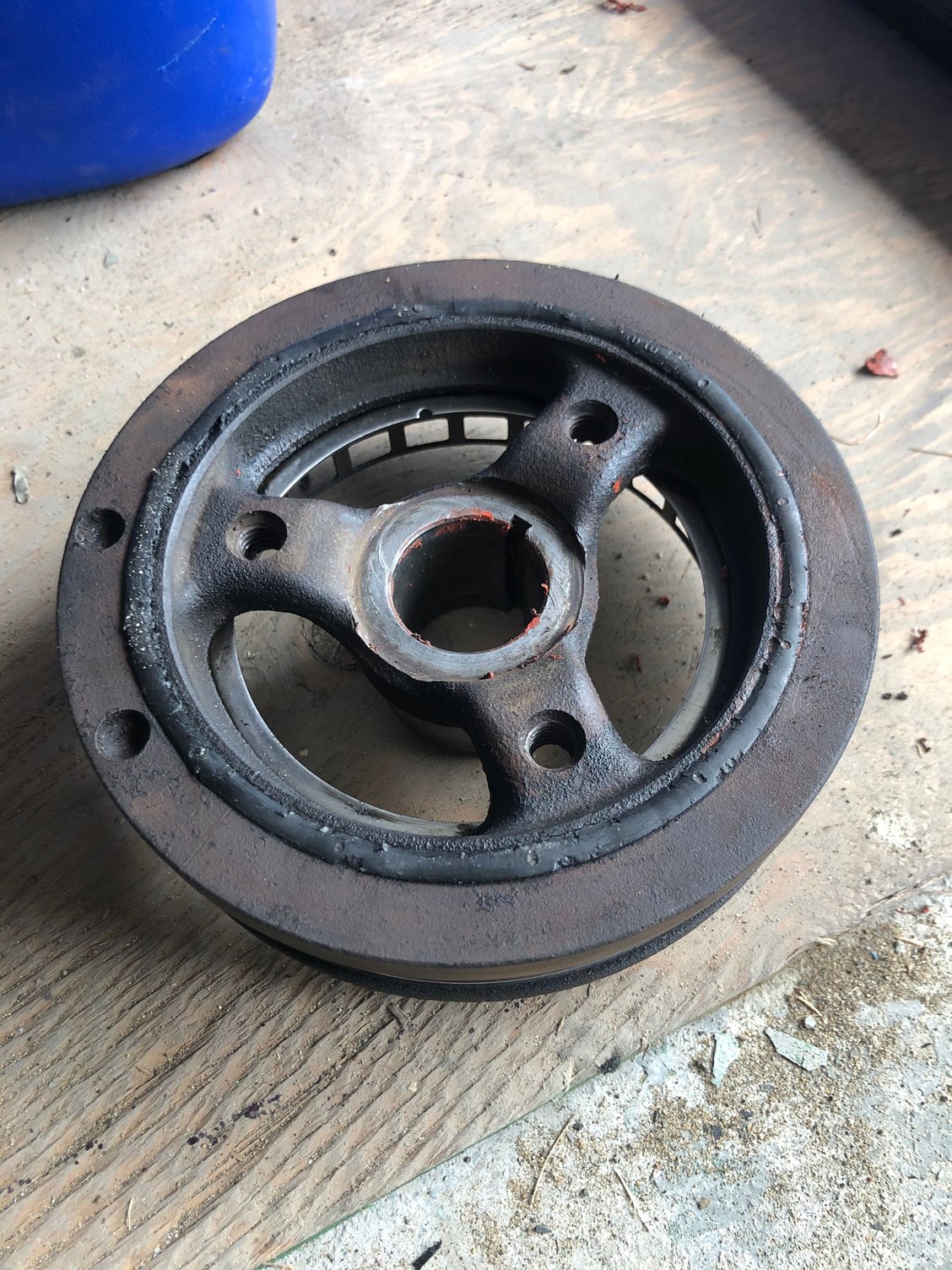

I have two, maybe three questions... here is some pic of the balancer I pulled off.
Before this job, the car had the engine code but no vibration, so I don't think the balancer is physically bad but what do you guys think? do I need a new one? It does look old but the rubber seems to be intact, no sign of crack yet.

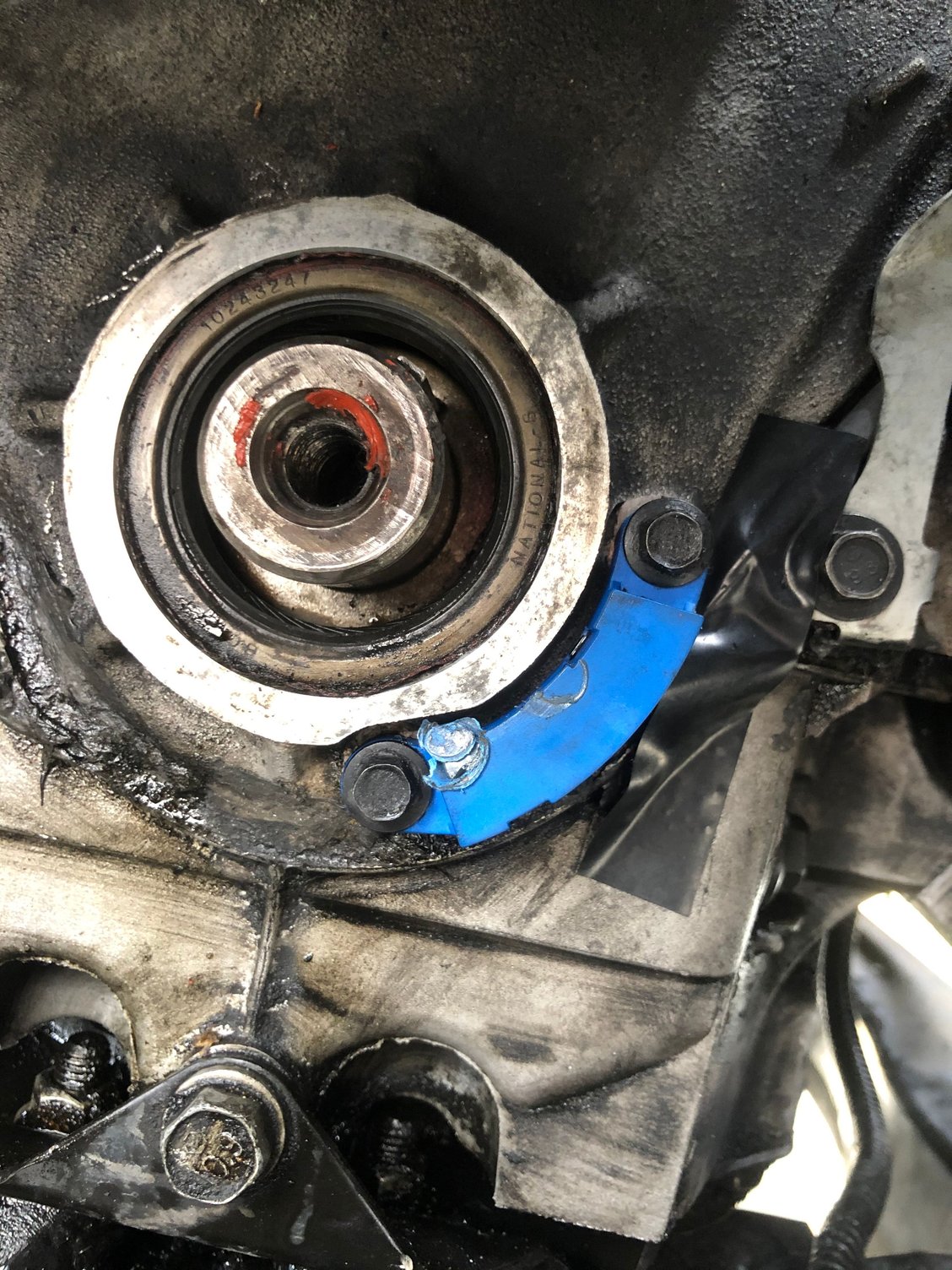

Second question is - after reinstallation of the balancer, I feel like I might have pinched one of the crank position sensor thing? the blue wiring thing that attaches to the front.. please see pic. Is this damage acceptable? does this mean that I have overtightened the balancer reinstall? so far the car doesn't pull a code so I'm hoping I don't have to buy another sensor as it was kinda expensive..
Thirdly I found some RTV-like materials inside the inner bore and the notch thing.. so I am about to clean those off very nicely and try the reinstallation again.. but could that have caused bad install to a point that it vibrates?.. how do I know when the balancer is fully seated? in idle when I watch the engine visually, I don't see it rattling much(if anything my tensioner seems more moving than the balancer). I manually tightened the center screw after installation tool doesn't let me turn the wrench anymore.. and to finish I just use impact gun to torque it because I just couldn't find way to stop the motor from turning as I torque - my impact is rated at 200lb so I know it's somewhat perfect.
What are your thoughts guys?
