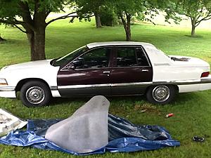

This is my 82 year neighbors car. Insurance did not want to fix it and gave her cash. I told her I could fix cheap and fast and we both will benefit. It has 442,000 Grandma miles on it. The car is a 92, The doors are from a 95. I little different trim and the mirrors are in different places. Whole car gets a front yard paint spray later.

91-93 B body doors are all the same for the front. Roadmaster sedan only doors in the rear. The attachment clips for the 91-93 interior mounts are the same as well. 94 door exterior is the same, but has the 94 interior mounts are different. The mounts can be swapped from the 91-93. You can swap the other front door for a 95 and make the mirrors symmetrical. The 95-96 mirrors are more desirable, and only fit the 95-6 doors.
You can move the strikers to make the doors shut tighter. The B pillar may be bent slightly, so check it out before doing a lot of tweaking.
