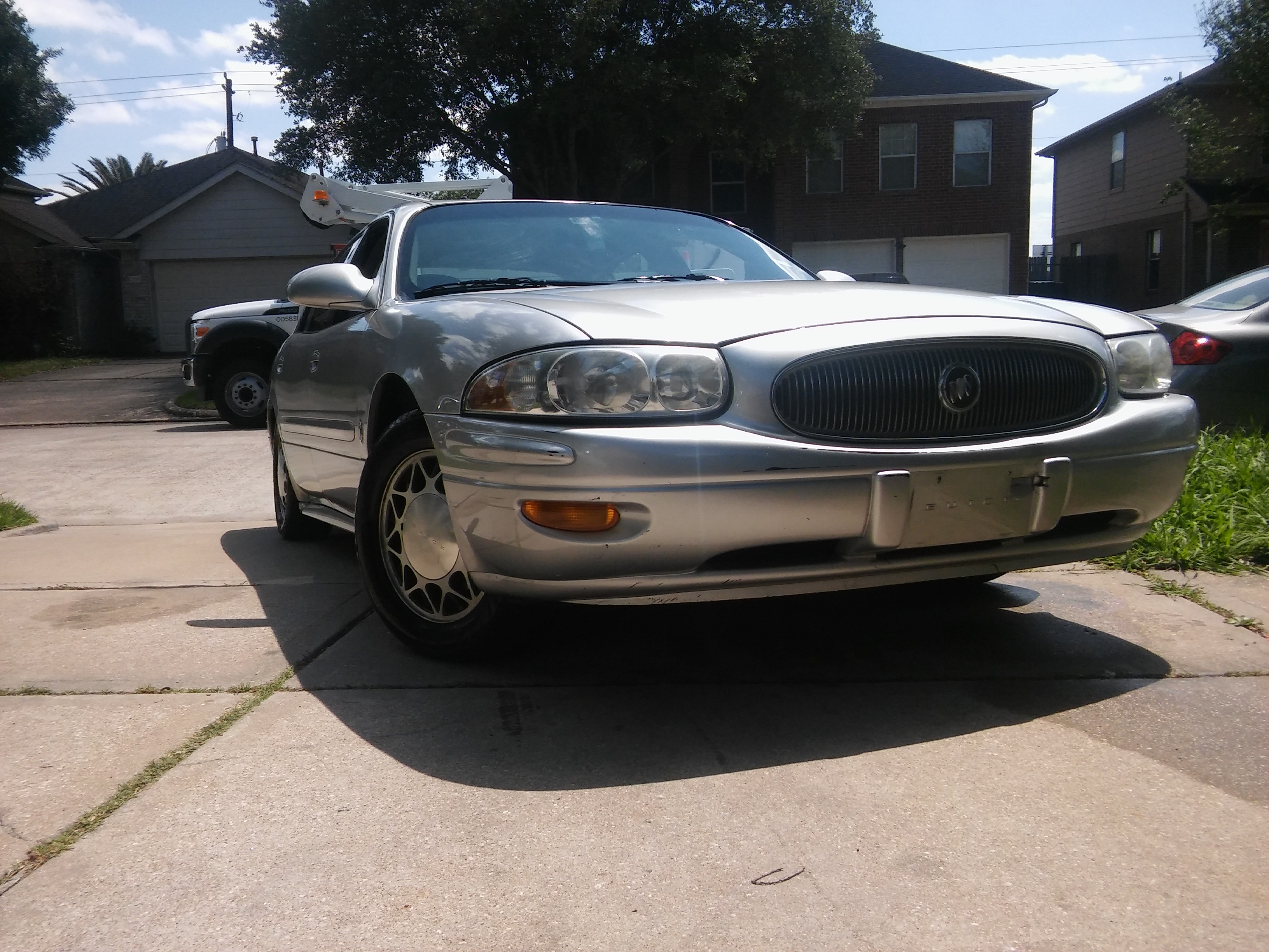

Need help. Have an 04 lasabre i will be rebuilding witb goodies and supercharger. I need to know my ecu options. Or HOW IM GOING TO MAKE IT RUN. will it run on stock ecu or will it need immediate tune. Im lost someone help.
2004 buick lasabre non supeecharged, custom. Can i keep same computer and just get it flashed or tuned?
