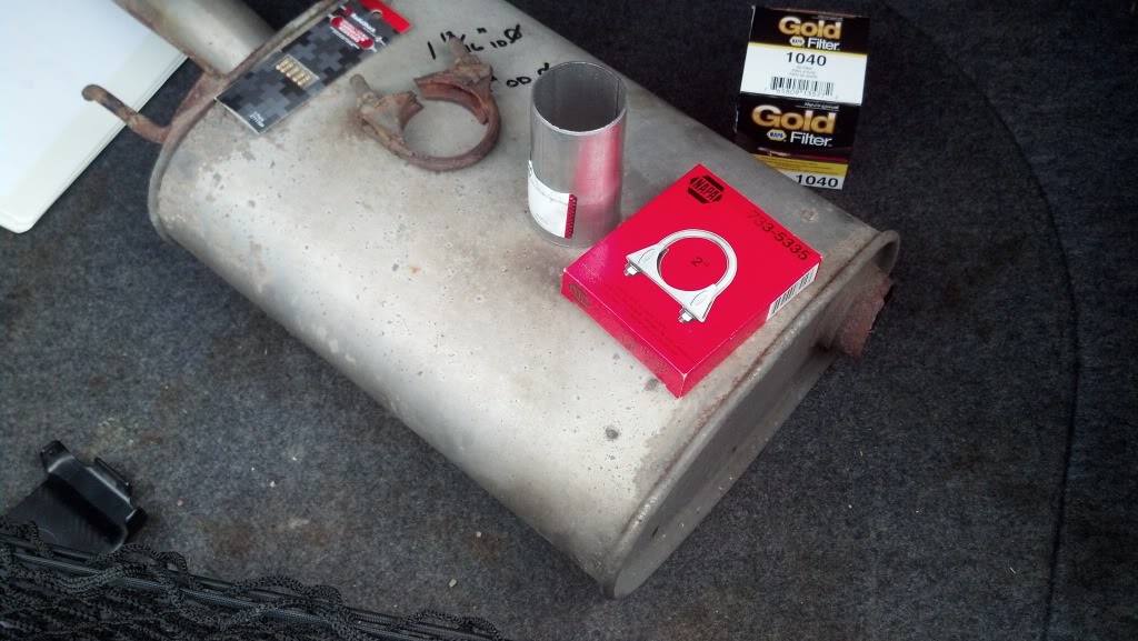

Here are some little parts i've picked up for it. A coupler so i can get the muffler back on, that was $4.13 along with a clamp that was $3.89. I'm going to get my friend to weld the coupler to the muffler as its still very solid then clamp it right back on.

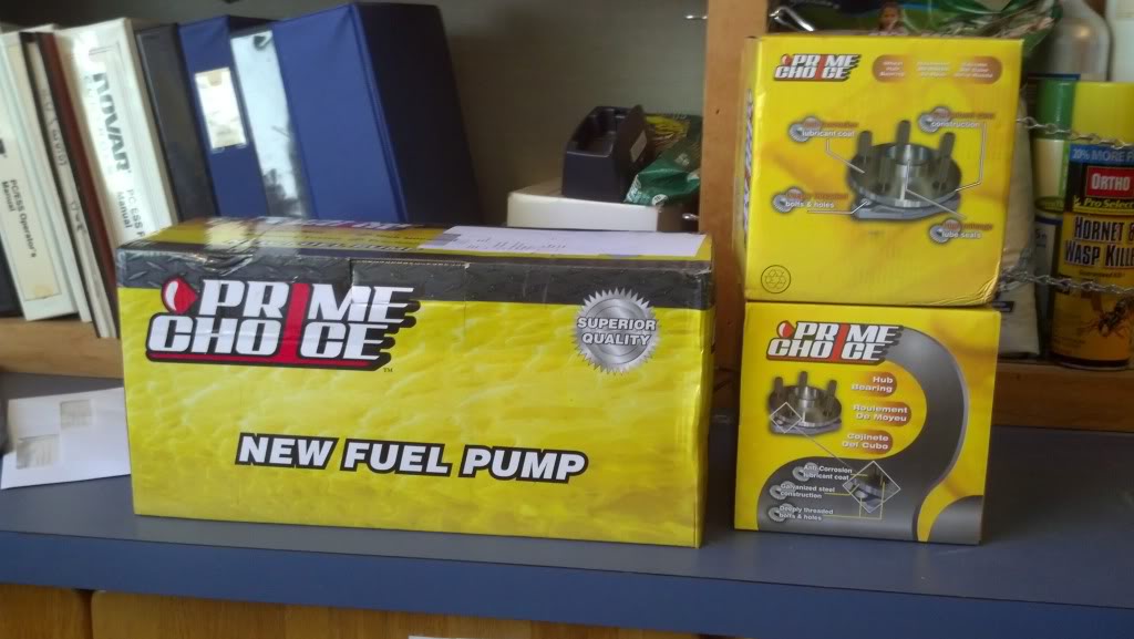

I found a local company here on EBay called prime choice, they sell the rear hub assemblys' to fix the ABS issue for $20.43 each. Since its a just a car i don't mind cheaping out here, plus they seem easy to replace. This same company sells a fuel module which i also need due to the fuel gauge not working. This module is $44.73, i'm sure it won't be wicked accurate, but as long as its in a vicinity. I will purchase these tomorrow.

You can see how the inlet of the muffler rotted off.

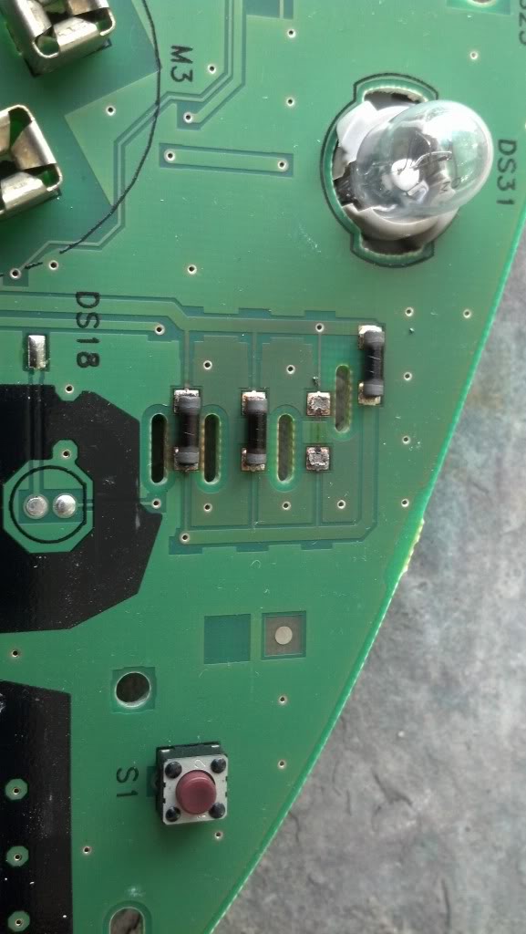

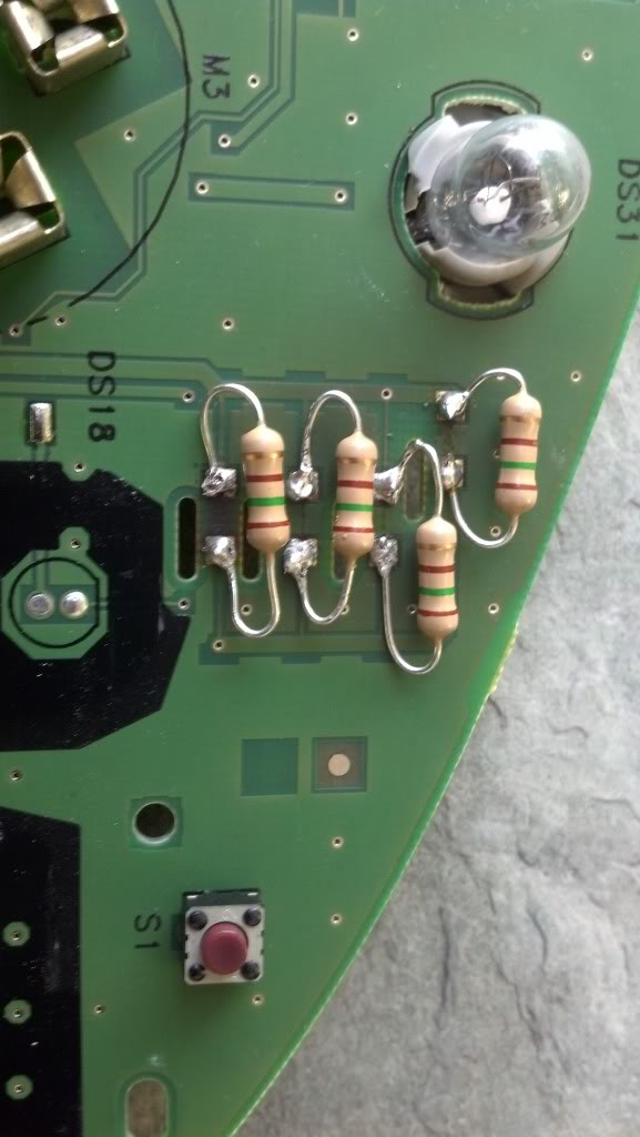

Well i've fixed the PRND321/Odometer. Pulled the cluster out and i could see where the 4 resistors were, but one had fallen out. I brushed the other three with my fingers and they fell right out.
[/URL]
I soldered the radio shack units in the best i could. Hard with sausages as fingers, but it looks mediocre. No one will see it.
[/URL]
Here is the finished unit, working digital readout for $1.49 and maybe 40 minutes of my time.
[/URL]
Pics of the new fuel module and rear hubs.
[/URL]
[/URL]

Got a lot of progress done on the Century last night. Got rear wheel hub assembly's replaced. Found one of the rear shoes cracked and the drums are rotted badly. So this will need attention soon.
Also swapped out the fuel module, which was a little more involved than i thought due to the fact its not plug an play. The aftermarket modules come with an upgraded harness that you have to splice in. Once you splice it in you realize you cant connect the connector to the module because their are 2 large prongs on the lock ring that stick up right in the way. Had to grind those down as much as i could. So far so good. The tank was pretty full, so the gauge is just off the full mark, so its definitely reading different than before when it was pegged full. I haven't felt any ABS pulsation yet either.

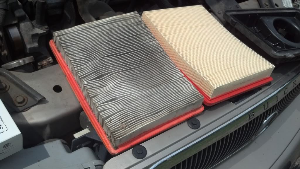

Not sure If I see it, did you also get the fuel filter thats just in front of the rear drivers side tire? 02 and spark plugs are also a great way to get you some more MPG. Cabin air filter is also another spot simple but overlooked but beware if you have pollen allergies. Once you take the cowl off from under the wipers take a pic of the black ramp looking piece so you know how it goes back when you re instal the new filter. Those 4 resistors are the ones that have the most issues. There are a few more on the left side with a few blank spots open. those were for the regal with tach and dic display.
