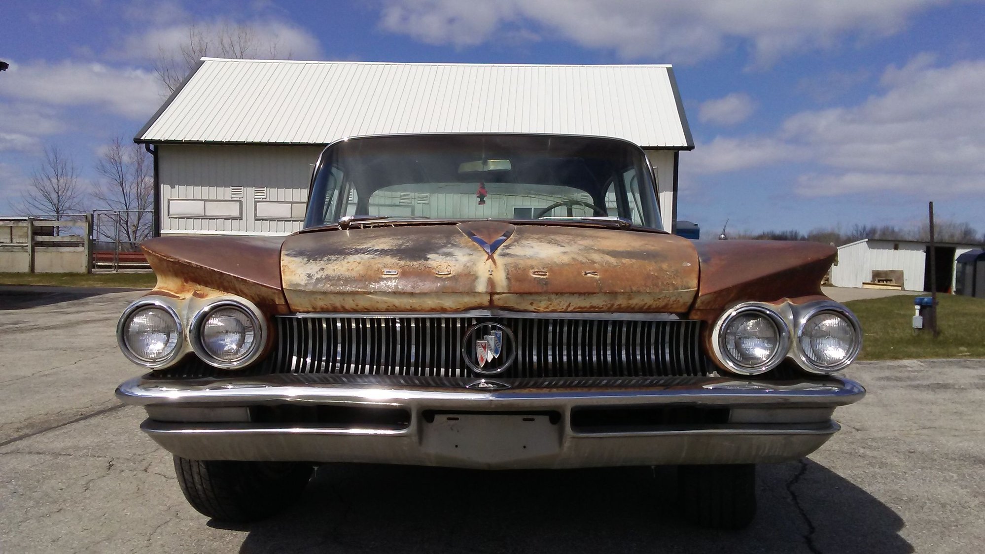

Hello Buick Forum! I recently got my mitts on my first Buick.
It's a 1960 Lesabre. It didn't run when I bought it but was complete. All the trim and interior, complete with about a thousand mice.
I've wanted to get a big four door for a while now, and I couldn't pass up the Patina on this one. So far I've cleaned the car up a little, swapped the single pot master cylinder for a dual circuit I had left over from another project and swapped the generator for a GM 3 wire alternator.

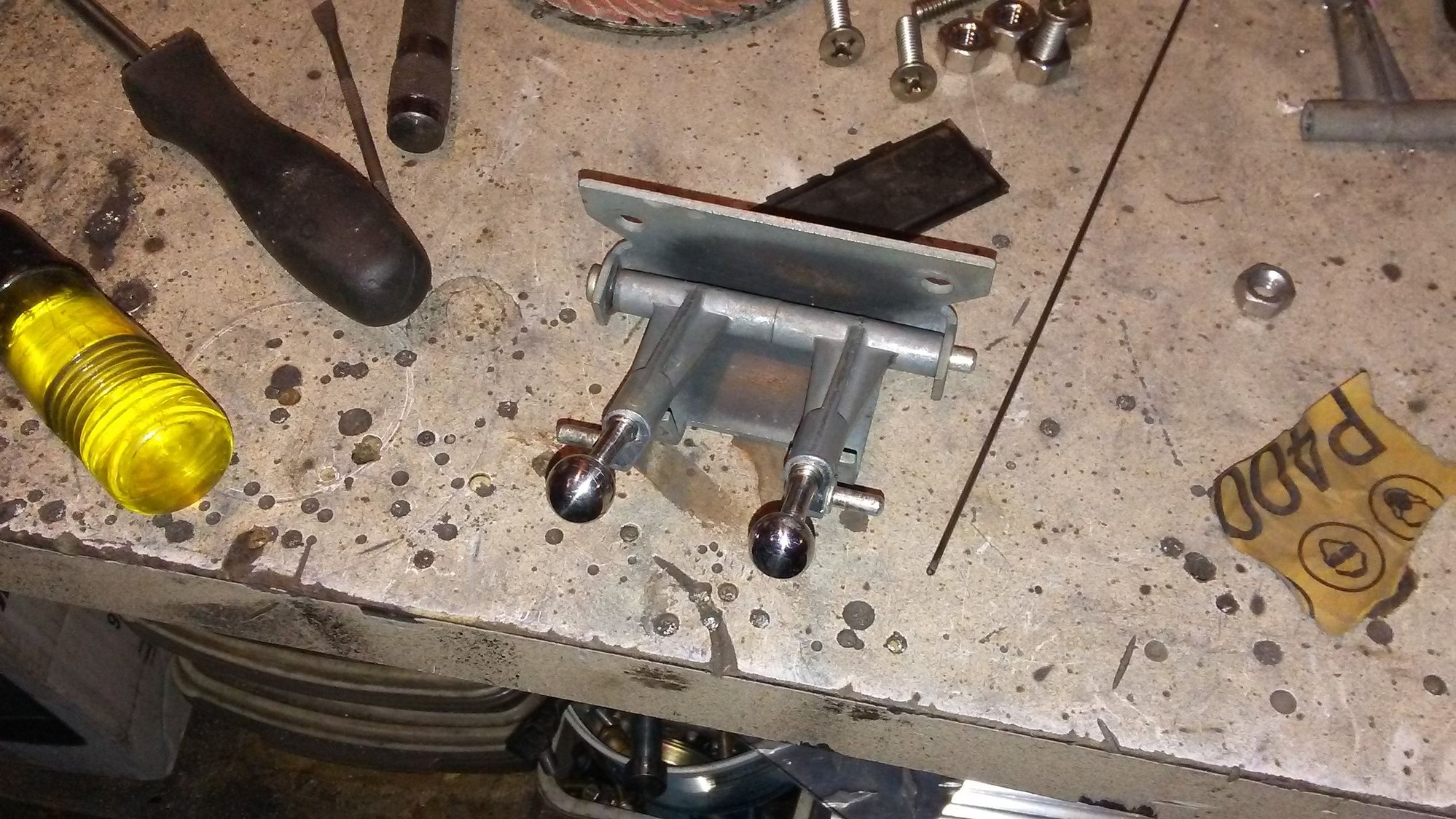

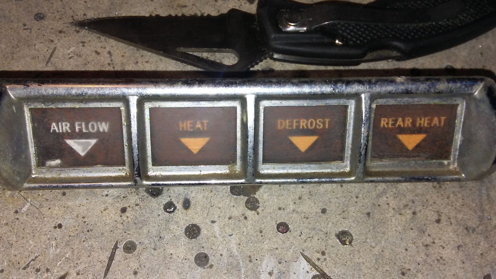

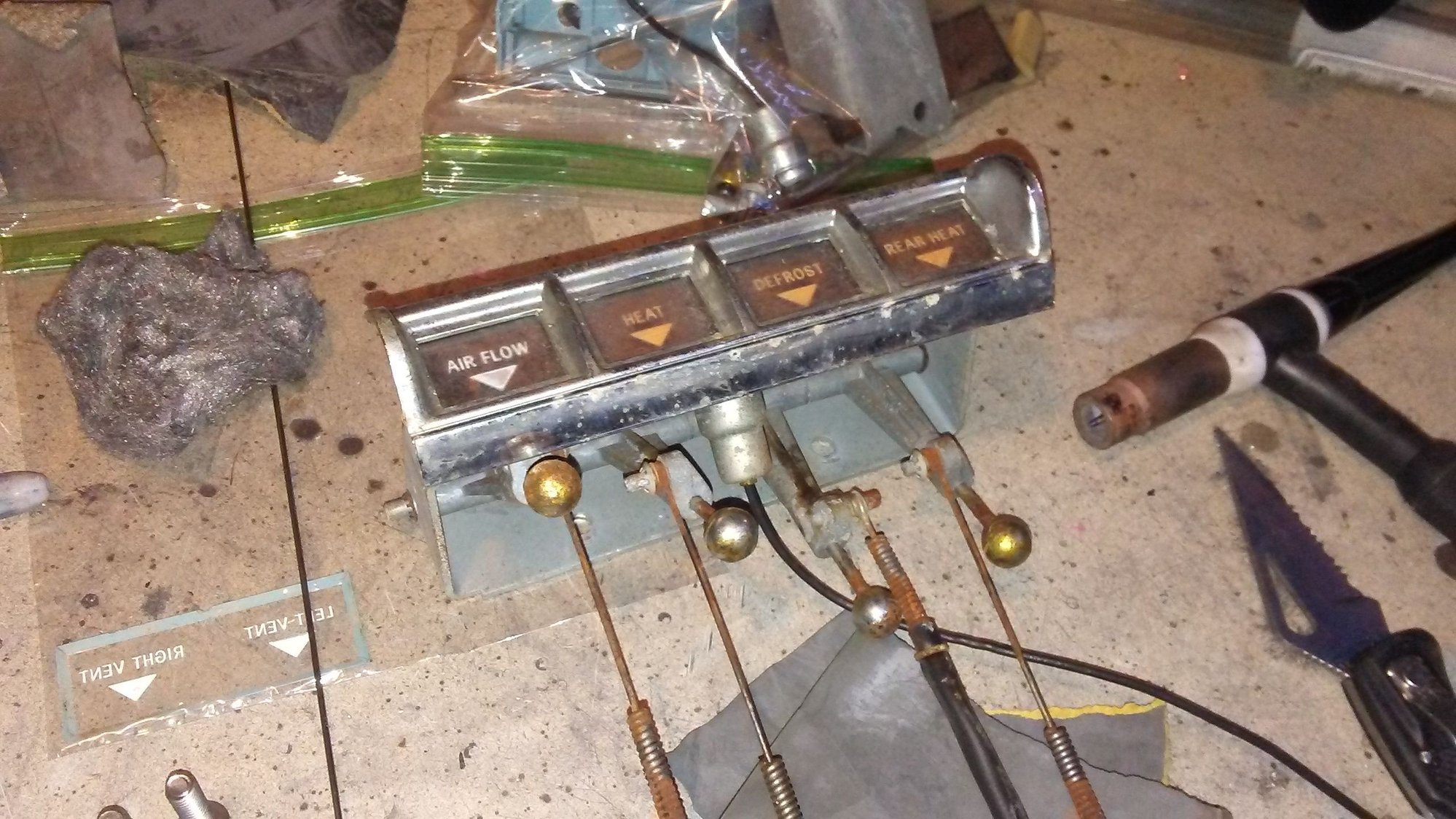

The first dash part I attacked was the adjustment levers for the climate controls. The chrome is dull, the plastic lenses are faded, and the black backing plate is rusty.

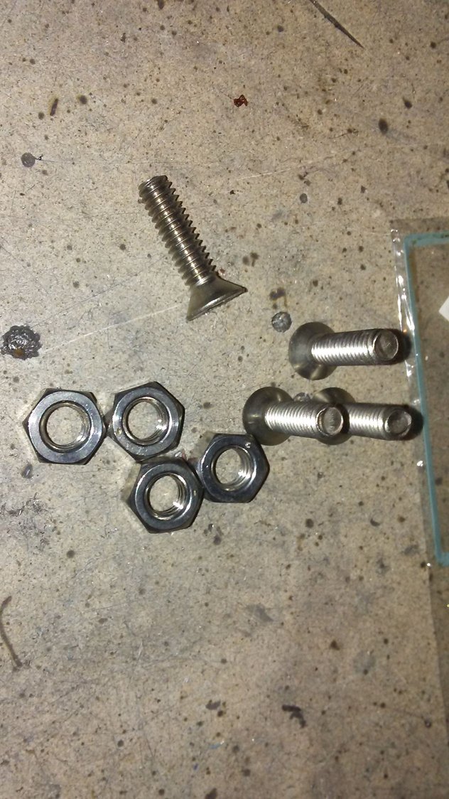

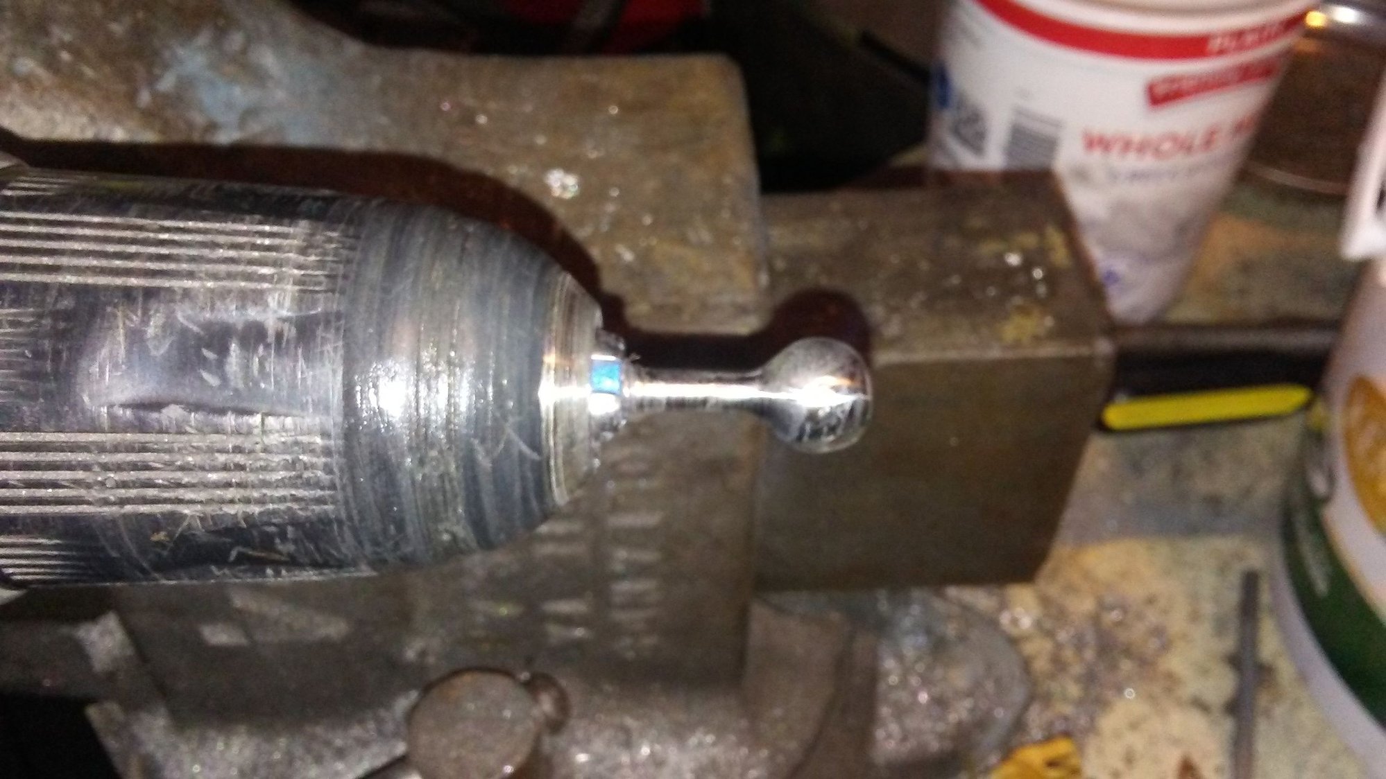

The solution was to remove the rusted beyond salvage ***** and replace them with stainless steel replicas, as I have no ability to have parts chromed.
I took a 1/4-20 stainless bolt, TIG welded a stainless nut on the end and filled in the nut with filler.
I ten used a rill and a file to make the rough shape and polished the pieces.

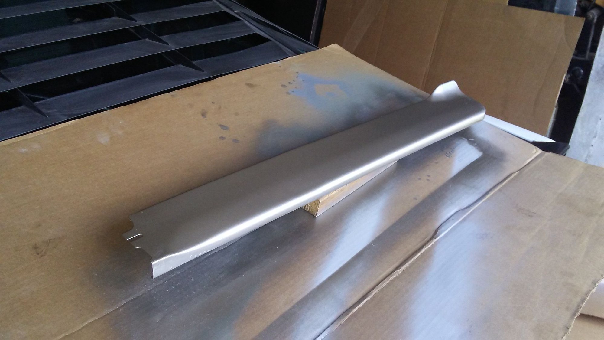

Here is the flint metallic paint I am painting the interior panels. It is very similar to the color they were, minus the rust.

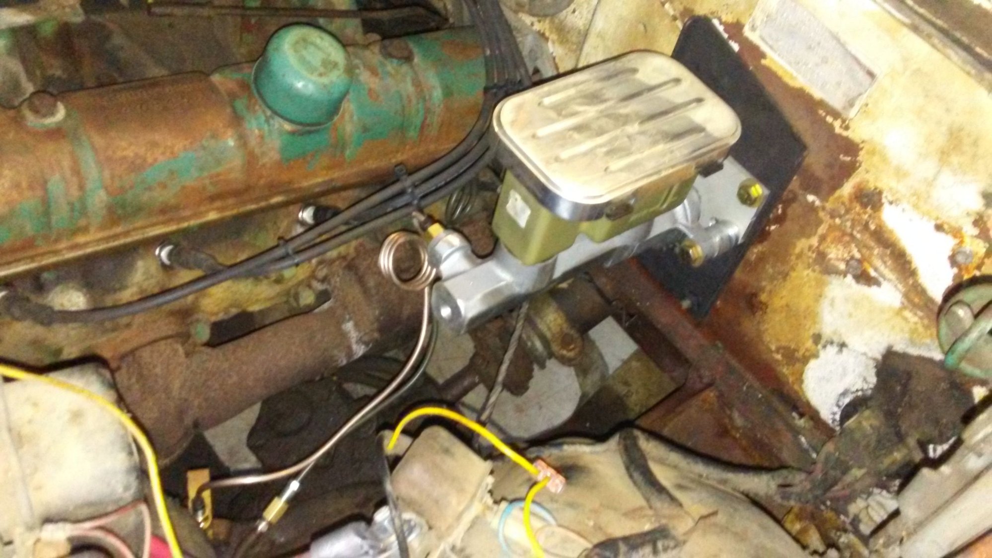

Master cylinder
Here is my alternator setup.
Here's the climate control panel. Chrome polished, plastic lens polished, re-painted the letters and back plate.
Painted a few more of the interior parts.

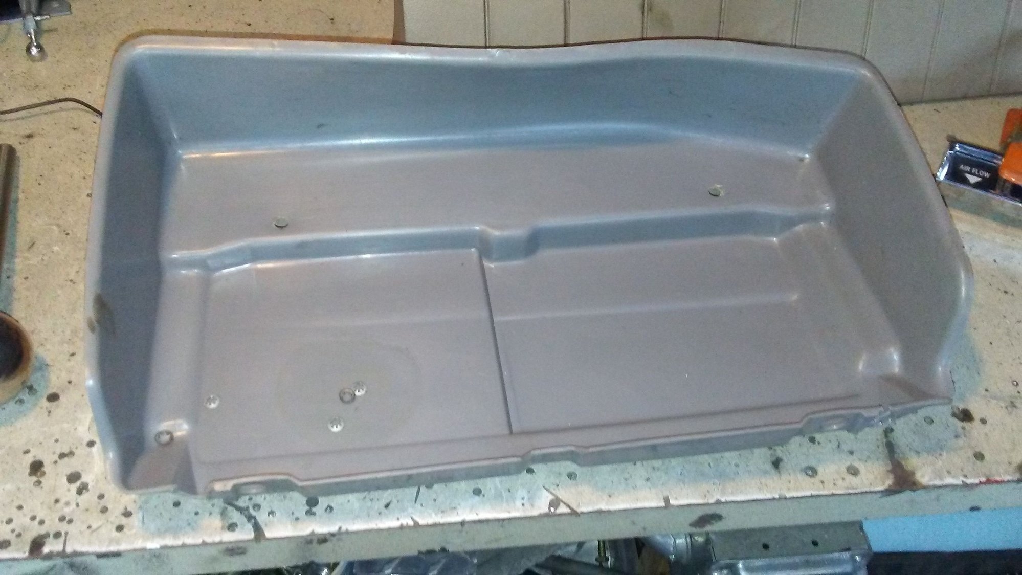

It's been a little while since I dropped an update, so I figured I would. I cleaned out the gas tank and painted it. Fuel pump. sending unit, filter and rubber lines all needed replacement.

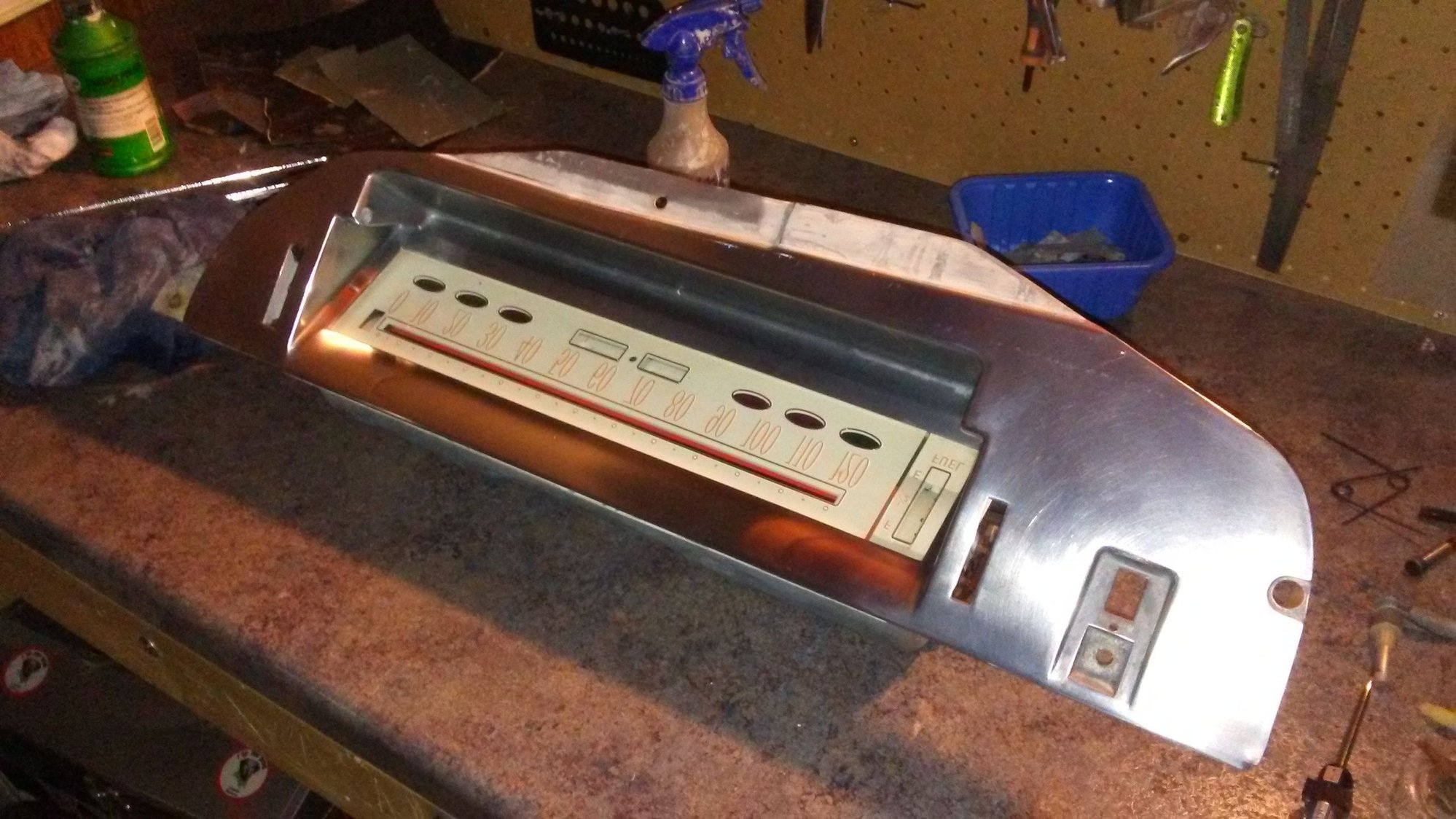

Cleaned up the guage bezel and started polishing the aluminum.

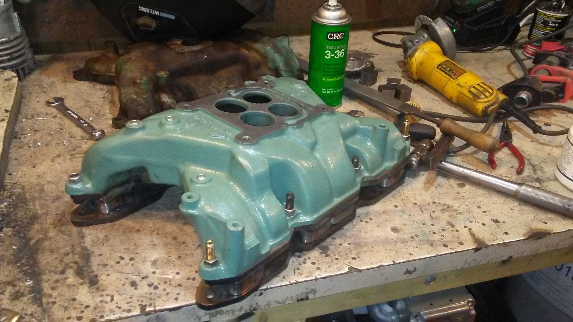

Small update for now: I finally got fed up with the ancient 2 barrel on the 364. Way too slow, way too crusty and just would not run right. The only solution is a 4 barrel intake off a 401 and a set of adapters!
