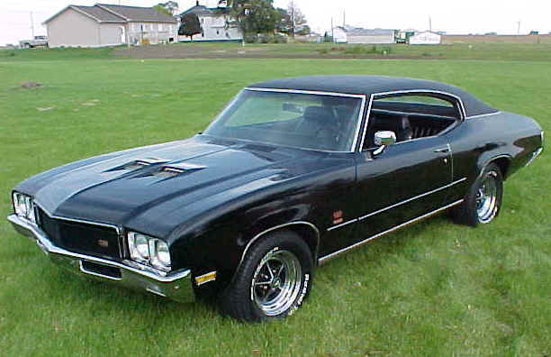

Like this style Buick, no idea what they looked like......
