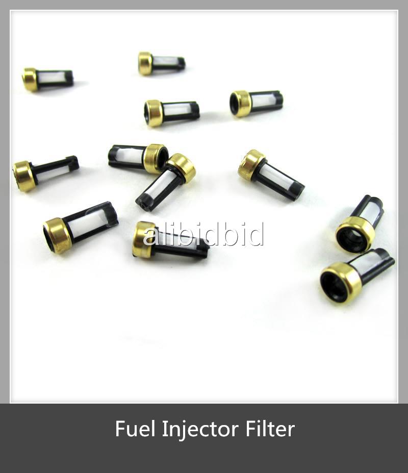

Being my first Buick and from what I gather, fuel pump in tank has been changed twice and this has a strainer at intake? Must have a fuel filter, probably sludged up?
Apparently some Buicks from the past decade didn't have filters, relying on the fuel pump strainer only. Secondary in line filtration of fuel injectors themselves may not be a stupid question knowing of Buick's sometimes strange ideas (as what were they thinking?).
Definitely a lack of fuel/enrichment problem, photo of injector filters (they do exist, maybe not used by Buick however). Now would like to see additional replies as again not trying to play forum monopoly.

I have changed the engine mounted high pressure fuel pump twice. In my lacrosse there are 2 fuel pumps. One in the tank and one on the motor.
