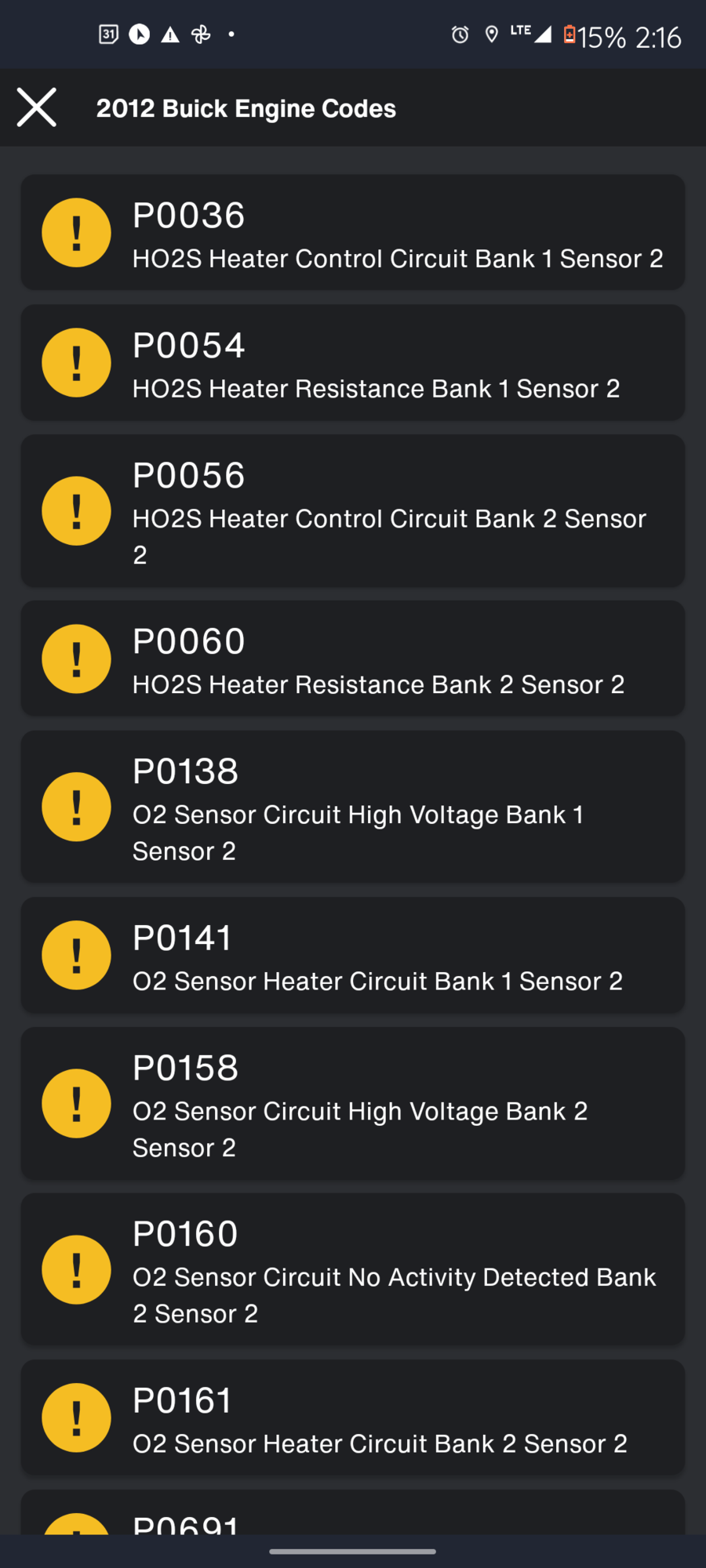

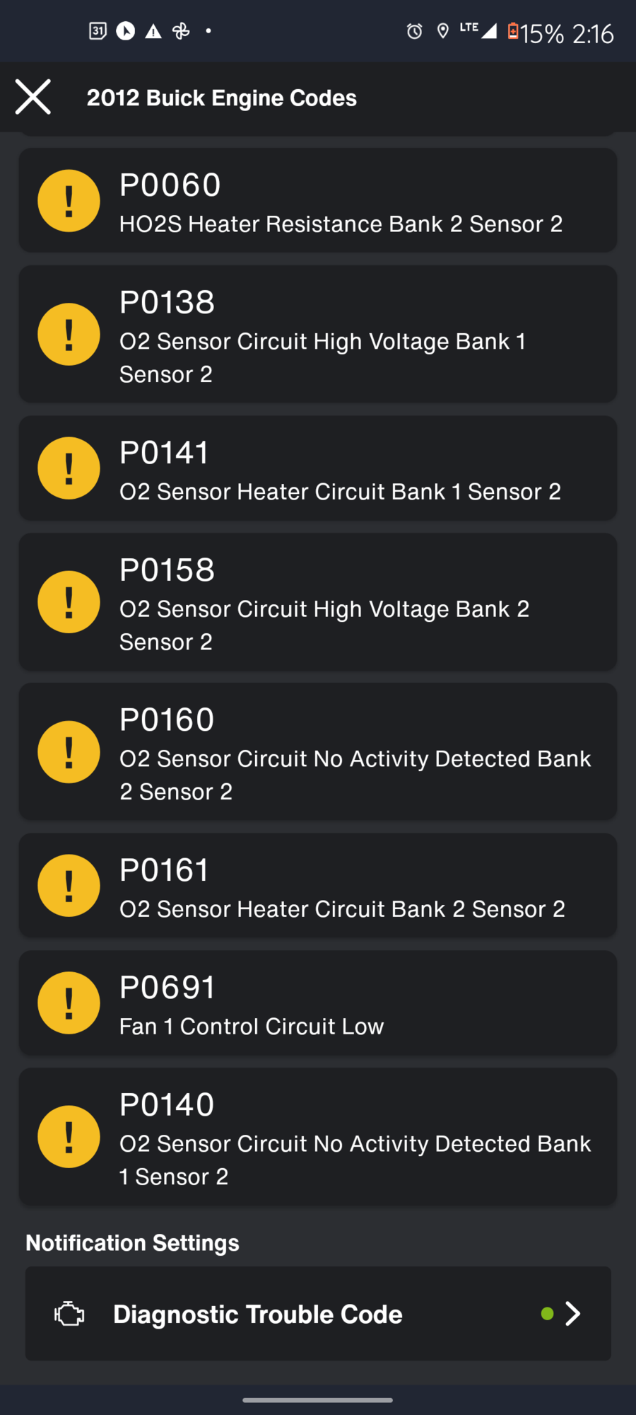

Old Feb 7, 2025 | 07:58 PM
TNHarrington2021's Avatar
Joined: Feb 2025
Same here
