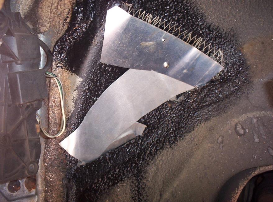

Well, I got the roofing flashing tar with aluminum sheeting on it. Here are 3 pics. Now, to wait for a good rain to see what happens. Ed

No water getting through their,nice job.I have a small hole in my trunk,im gonna steal your fix for it..

That's a nasty rust hole. Looks like you have it sealed up well! Fingers crossed it's sealed
