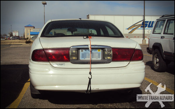

Nobody ever oils their hinges either. Graphite, silicone or something that won't collect dirt works very well. Hate to hear the crunching, can't latch door or fairly new car with squeaking, creaky hinge sets, no excuse for it. Or what about the hood or trunk that won't lock after slamming down 2 or 3 times? It never ends lmao, guess that's what bungi cords are for. Now we're getting into WalMart car show OEM stuff.
