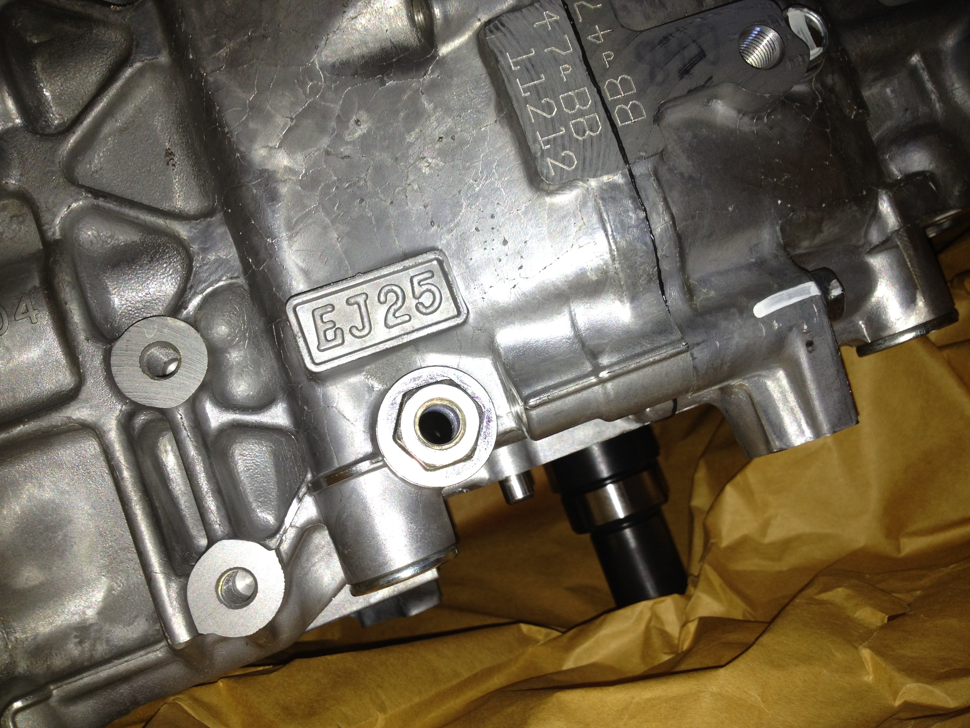

Didn't do much besides coolant flush t stat and water pump.
Got my STi bottom end in just need more pieces to finish the build
