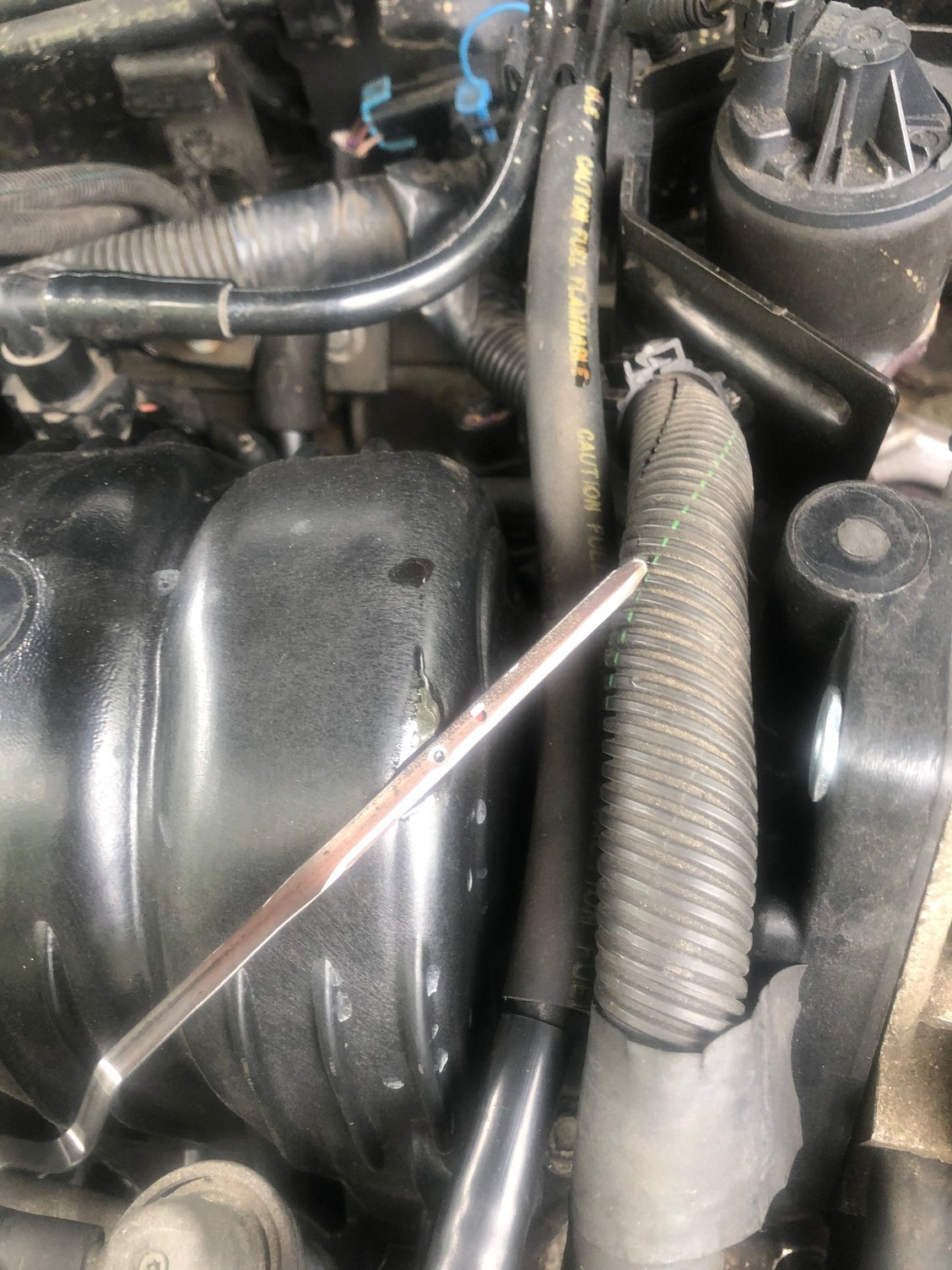

Around 101k It was running really rough after about 100miles on the road, so i parked it and it wouldn’t start after. towed it home. pulled the plugs and the engine was hydrolocked, 4/6 had coolant come out of the plugs. After confirming it was the upper intake gasket, i replaced both it, the upper intake manifold, the EGR valve (the smaller diameter one they include in the kit), PCV and pressure sensor that plugs into it (I broke it), as well as thermostat and gasket, spark plugs again, oil change again, and a coolant drain and refill. Cleaned the throttle body (very dirty), MAF, and everything around the upper intake manifold since i had it off. replaced fuel injector O rings, cleaned area where they went in, etc. put it back together, drove it 500 miles, no longer was eating coolant. Then did another oil change and replaced spark plugs again, and confirmed that there was no coolant in the oil/visa versa. Was throwing a code running lean, figured i cracked a vacuum line, and didn’t mess with it since it was running fine and wasn’t doing anything new. eventually got around to it just a small leak and fixed it.

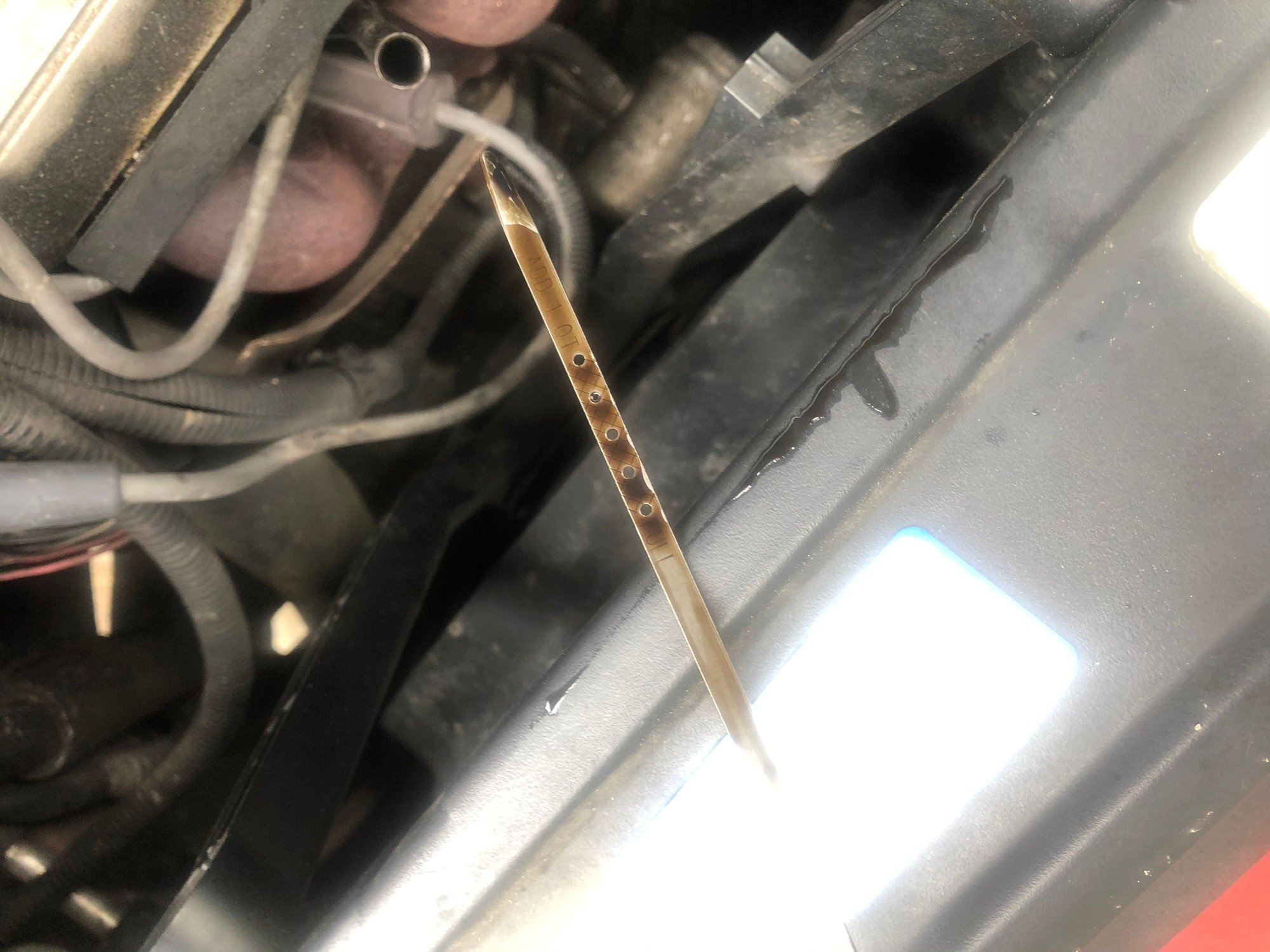

Fast forward to now, 105,500 After driving about 400 miles over the span of 8 hours with a few breaks, i notice my issue now. I can feel it in my feet when it does it, it’s like the engine is stalling/just running rough or possibly the transmission? it really only does it when i know it’s in the bottom end of 4th gear. 50mph+. I replaced the TPS after reading online it was common and my symptoms matched it, as well as all the coil packs. After this, The idling issue went away, so i’m thinking it was unrelated. “Hiccup” in trans/engine got i think maybe better but i also let the car sit overnight. Engine runs fine it other gears both low end and top end. transmission has proper level of fluid and is very clean. I’ve smelled and tasted it,
no issues. engine oil is good too. not eating coolant, or leaking it. engine seeps a little oil out but it doesn’t leak or eat oil either. Oil pan is dented which happened around 103k but it was because someone lifted the car partially on it, but also lifted off the frame at the same time. not a big dent, i don’t even think enough for it to affect the dipstick, doesn’t leak either. transmission has always felt normal for a 23 year old car. i don’t think it’s a fuel issue because it doesn’t stall out and it’s fine at all other speeds and RPMs. Other things to note, my speedometer and gas gauge don’t work. When i put my turn signal on, most of the time the speedometer “jumps” like it gets a surge of power. all other electronics are good, car is in good shape inside and out good brakes good suspension not a lot of rust. I read online that the ECMs can be problematic and it makes sense since it was replaced before, but i’m not sure. Or maybe something electrical? I replaced the radio and have 2 10” subs running at 200W. i’ve checked the battery and alternator and they read good levels, don’t rememebr exactly what they were it was when i first got the car but I wanted to make sure that it wouldn’t be an issue to run them. I really like this car and how easy it is to work on and kinda at a loss for what it could be. it’s drivable but i’ve had vehicles with transmission issues in the past, which makes me worry this could be that as well despite the new trans only having 45k on it. any help is appreciated, thanks!

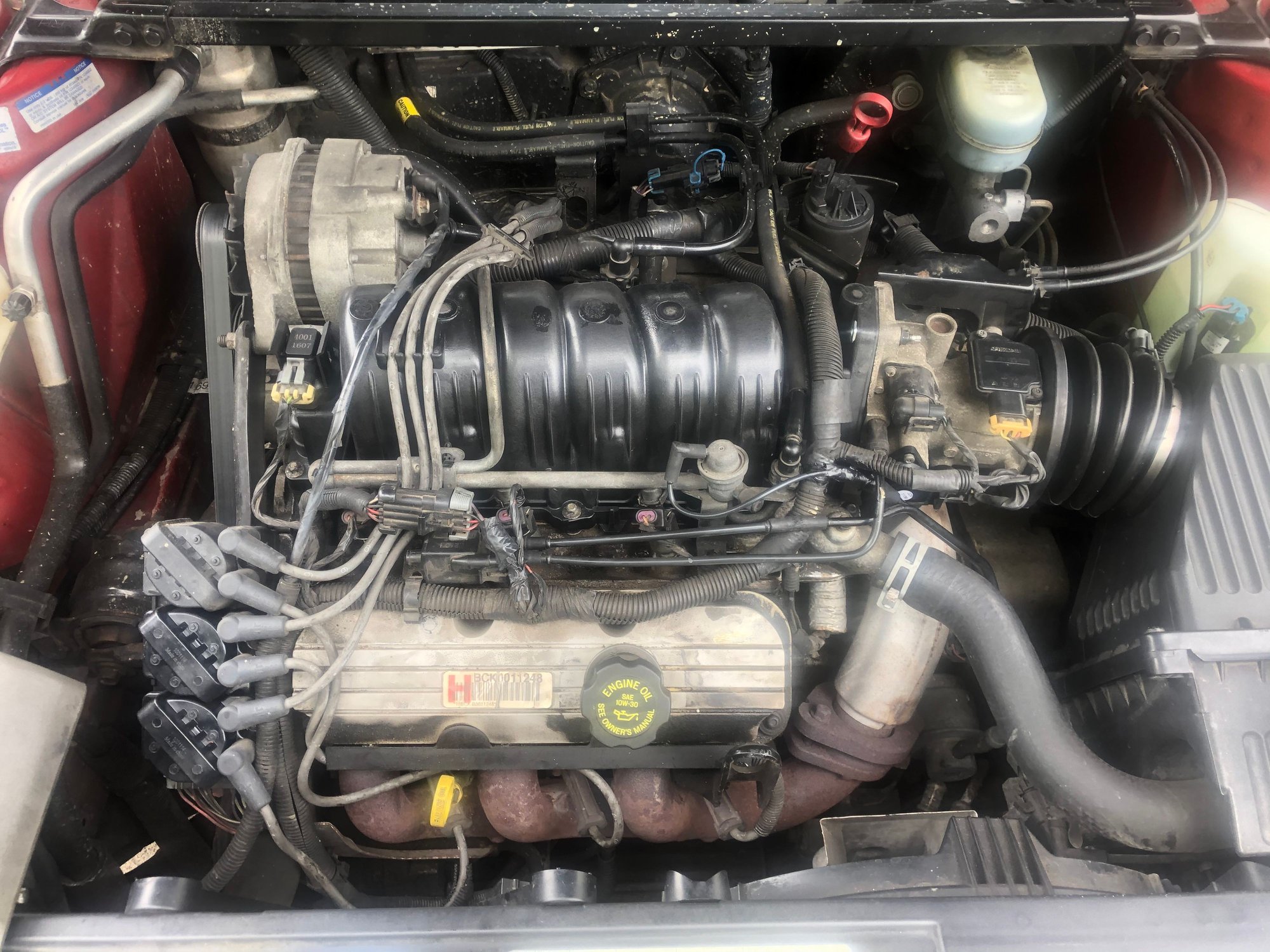

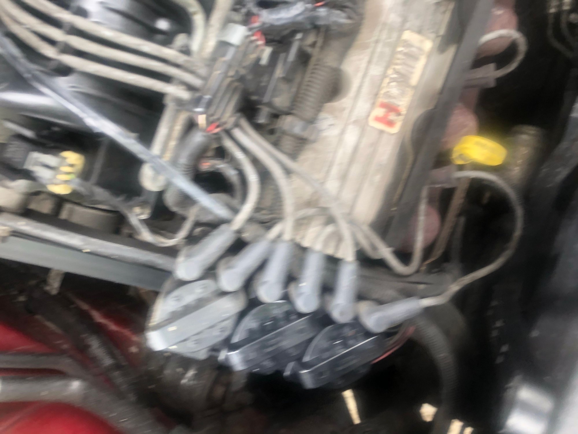

As you know, any good diagnosis always begins with a good visual inspection.
I am not positive on what I see could be causing the problem , but when we see something not right, that should be correct before going any further.
Sooo, looking at your pictures, I see something that could be causing a problem. The plug wires appear too close to the exhaust manifold, and will provide a place for spark to jump to ground, not good. Suggest you reroute them and don't allow any 2 wires to run parallel to one another that are next to one another in the firing order.

I’m not very sure how to reroute them, the way they are is the way it came from the factory. where the cables in the front run there are clips made for it to go in but i routes them over the valve cover and the tears do no do the same so i just made sure they weren’t co close to anything not or metal.
6,2,4 go to rear. 1,3,5 go to front. i made sure they were in correct order on the coil packs too
