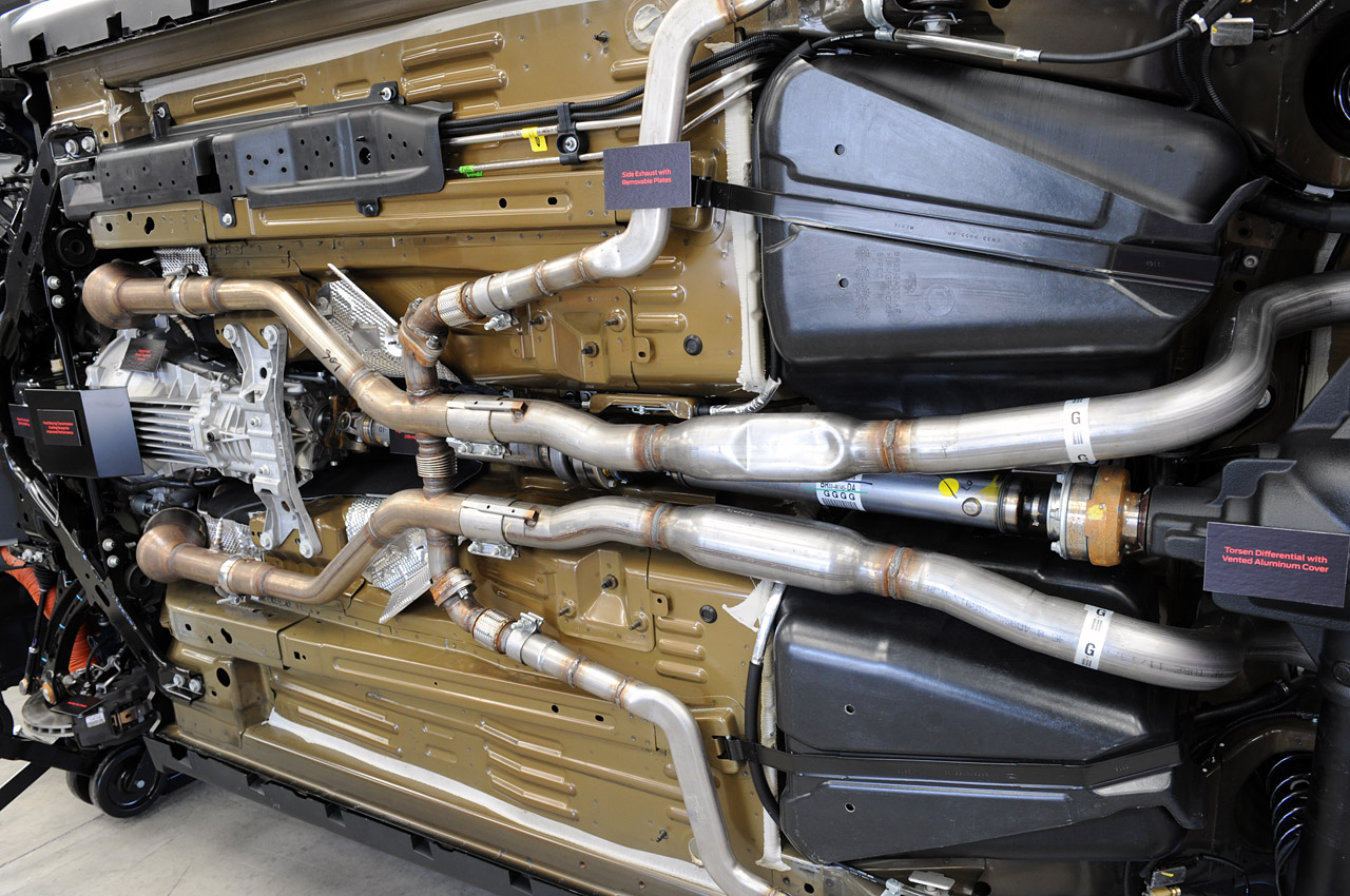

Still use the pull choke on my lawn mower and snow blower today. Does your dual exhaust have the equalizer pipe between the left and right side? Started seeing that myself around '79. Photo showing this (excuse side pipes). WAIT- Never answered the question lol, try again. Answer is wrong- this is something different, hmm.

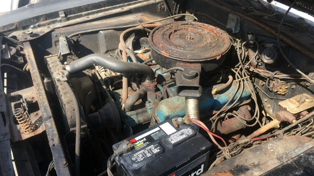

(Wrong reference was here, not what looked at), hope this works: https://www.bing.com/images/search?q...alve&FORM=IGRE. Apparently this valve is also part of the cast exhaust manifold and connected with EGR system. In learning mode also on this one. But guess what, had the heat tube on the '72 Duster not road runner. Another photo, silver tube going to air bonnet (photo from net). Great refresher here, that all was a long time ago. A lot of fun with this one..... All entertainment.

Your welcome and roger on that info so far. Just had that photo of car underside to show connection between left and right banks. If it's the flange that's leaking the muffler shop maybe forgot to install hi temp gasket. If it were the ball and socket type connection would self seal. I may of misunderstood question after first not answering at all

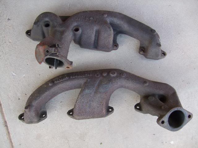

Also checked on road runner manifolds, what I was thinking of (photo). These were used on both 383 and 440 CID. Note diverter valve for warming. Didn't recirculate exhaust but heat from manifold a bit different from the '72 Duster. Things were advancing rapidly, no catalytic converters as yet. First PCV valve I ever saw though. Seems in '67 there was just a hose from oil cap going to carb base?
Oh yup, side pipes with flanges and those have gaskets with different size holes for sound or take out completely; fully open gasket is used in that case. Not that loud, tips face the ground. Different gaskets: https://www.bing.com/images/search?q...sket&FORM=IGREAlso checked on road runner manifolds, what I was thinking of (photo). These were used on both 383 and 440 CID. Note diverter valve for warming. Didn't recirculate exhaust but heat from manifold a bit different from the '72 Duster. Things were advancing rapidly, no catalytic converters as yet. First PCV valve I ever saw though. Seems in '67 there was just a hose from oil cap going to carb base?

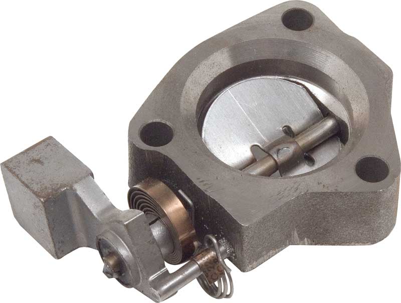

Looked up EFE valve and they're about the same thing as heat riser valve but vaccum actuated. Photo of heat riser valve. Reference Manual: Chapter 10: Emissions Equipment: EFE System
