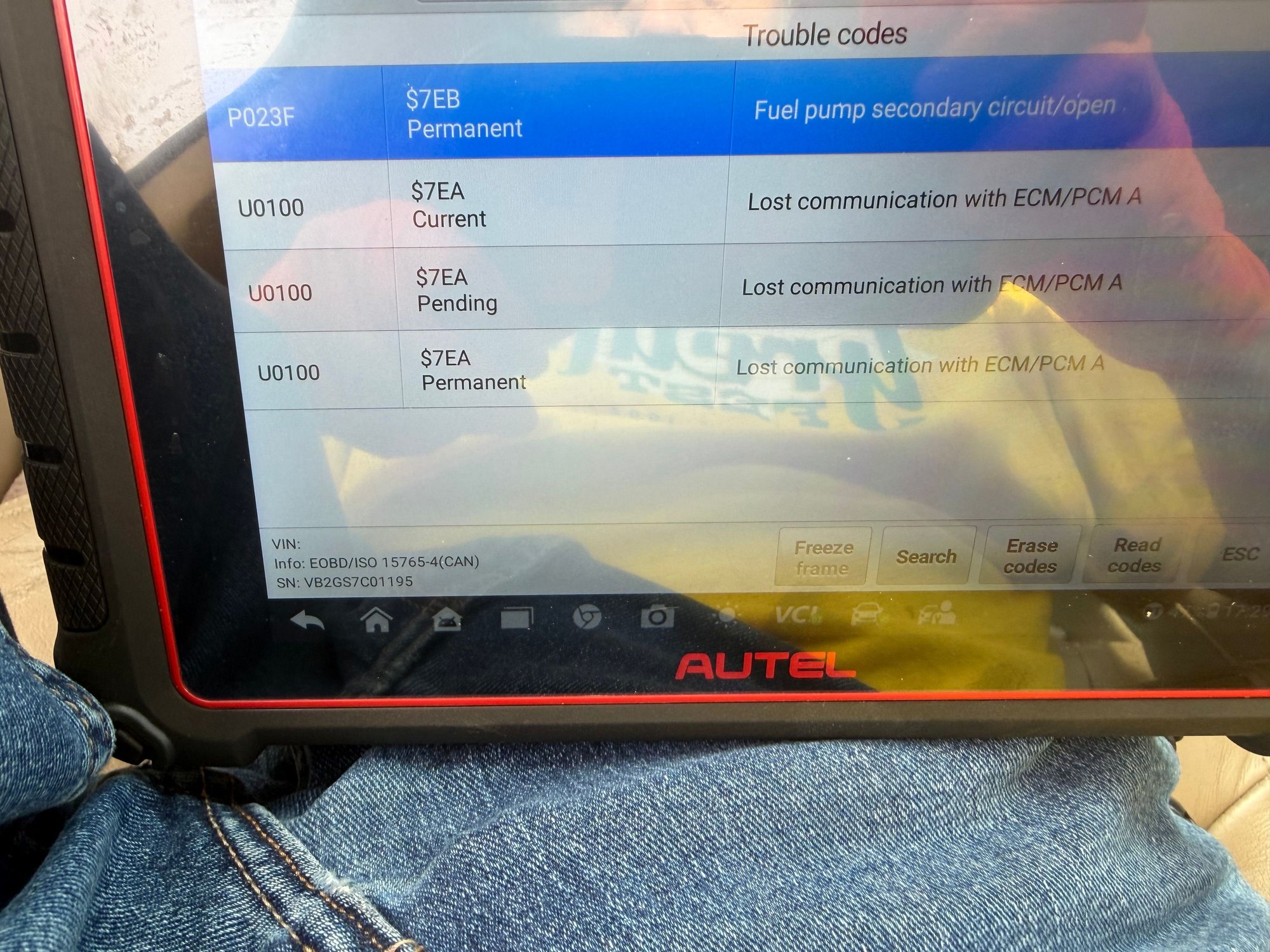

Hi all,
I am working a 2011 Lacross.
When I put my foot on the brake and press start, the car will not crank and the Che k engine light rapidly flashes. Sometimes when I press the start button, I hear a mechanical noise, it’s not the starter, coming from under the hood. It’s like a plastic clicking noise.
I have swapped the fuel pump pod, new ECM, checked all my relays and fuses, and checked the grounds that I can find.
Battery is good. The customer put a new starter in thinking that was the issue. Both key fobs present.
Any help is greatly appreciated!
