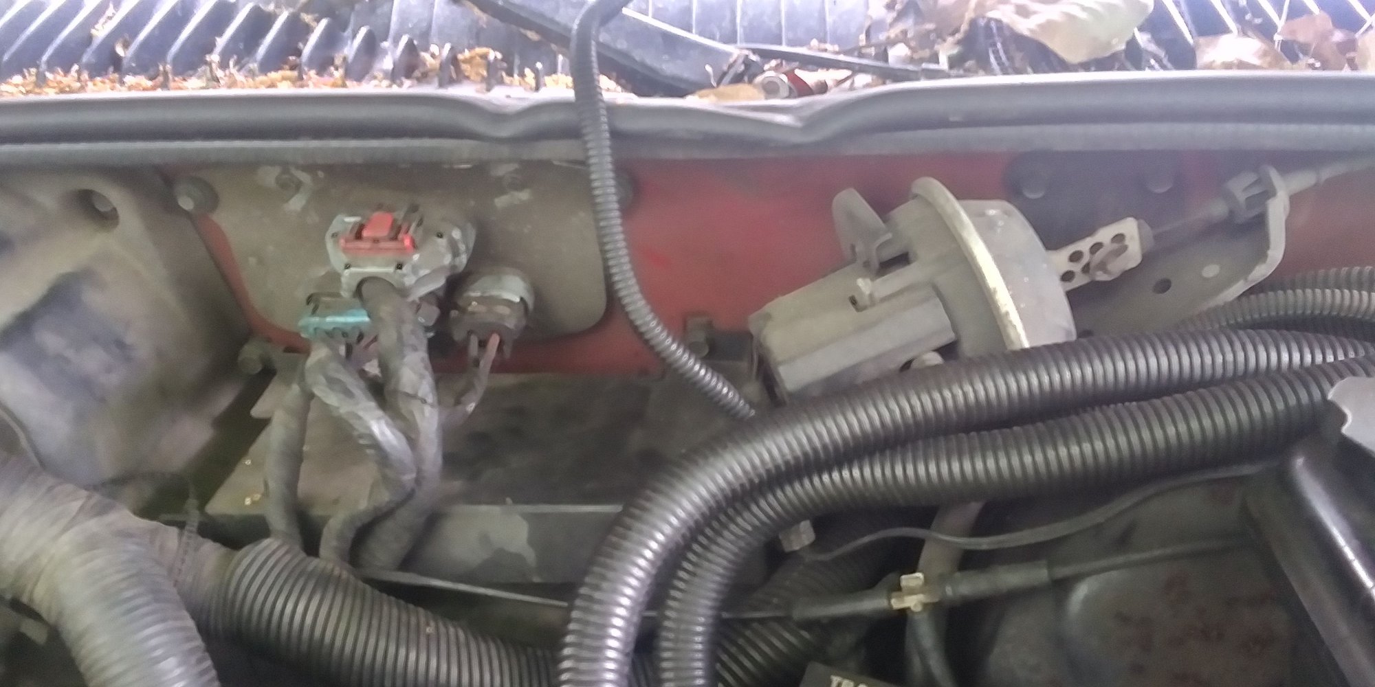

I checked around all sides of the radiator but do not see any relays. What do you mean by curbside?
A Q&A I found on Fixya said it was in the middle of the firewall (engine compartment side). I took a photo in case that might help.

I found it!
There are 5 relays mounted inside a black plastic box that is mounted to the firewall. The fuel pump relay is one of them.
