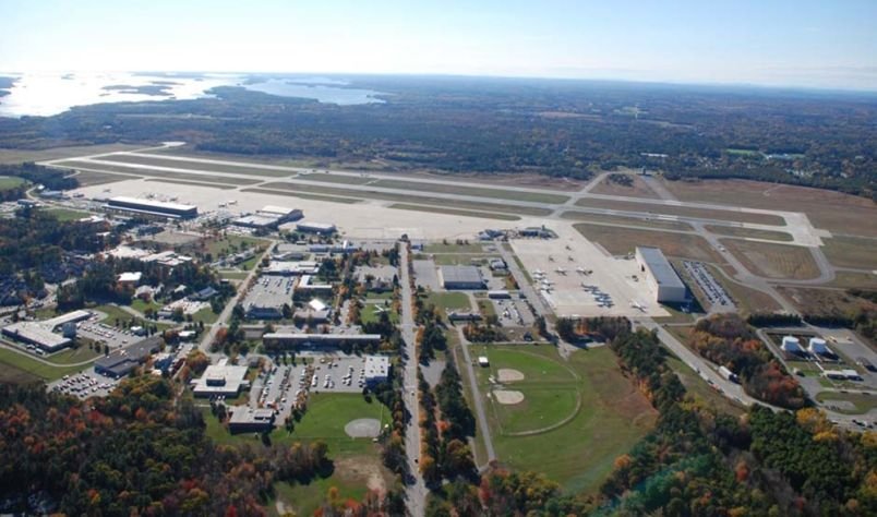

Thanks Hanky on that explanation, didn’t realize myself. Where I worked had a fuel farm no less. Jet fuel up to JP8 level but that was almost a decade back. Was always working on those Scullys and then the hazardous spill alarm......
One time a sheet of ice slid off a roof and opened the handle on a ball valve at the pump station. No lock out on it- nothing. So fuel leaked out on the ground all that weekend. Alarm never detected anything as that though, though it was criminal mischief and NCIS shows up, hmm. Not so, had same thing happen at home with a water faucet, imagine. The entire area contaminated; duck pond, stream, all low areas and more...... see if I can locate actual photo of place.
