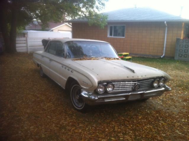

Well I'm pretty sure she has the 2 speed...the research I have done has led me to that. Mind you the transmission does say 'Dynaflow'...well my spare anyway! And just for you Hanky I'll post up an attacthment pic of my 225.
I look forward to driving her with my family...sunday cruiser is what I had in mind for now (I havent started it yet in the time I've owned it...but as previously mentioned my procrastinating is done!) and should be very reasonable to start with anyway. Until I have more time that is.
Not really the place for it but shes got p/w p/b p/s dual exhast along with air ride and pwr front bench seat. I have a dash clock but it isnt installed as it wasnt an option on this car. Original paint and glass. I have a few spare parts like a windshield and transmission, intake (the list goes on). The car was purchased brand new, locally off the lot in town. I'd like to try and find the original owner but that might be a little difficult...and I do have the original warranty book!
And sorry in advance for the iPhone pic. This was last fall.
