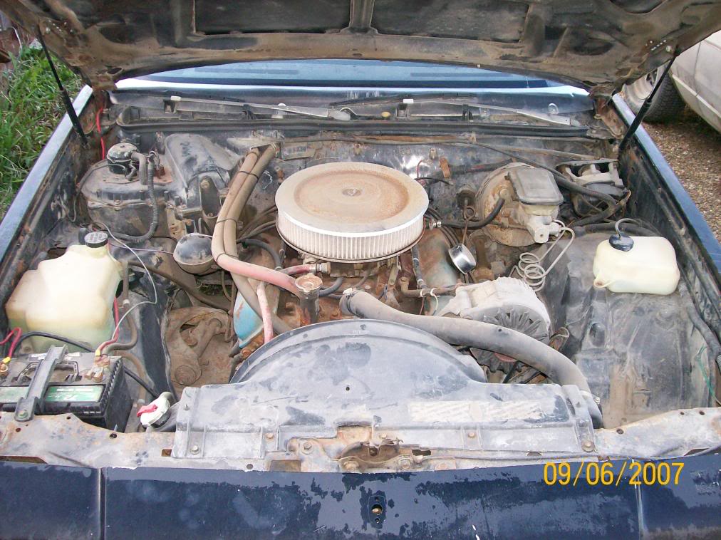

Hey guys. New to the forums here. Anyhow I have a 1984 Buick Regal Limited that has a swapped in 350 out of a 77 olds. That seemed to have gone fine but now I have brake problems. Last summer I was driving it and the brakes suddenly went very soft on a brake and went nearly if not all the way to the floor. Now I have drove it to where it is parked and I fired it up a couple times over winter and drove it around the yard etc and tried the brakes. Still the same thing. Now I have had all 4 brakes bled several times and there is no air in the line. I thought it was the front pass caliper and i replaced that earlier cause it was sticking on and pulling to the right and got very warm. So I am wondering if it is the brake booster or the master cylinder. What do you guys think? I want this baby on the road this year again.
Under hood:
Attachment 820

if the pedal goes to the floor, and you have already bled ALL the lines, then i would replace the master cylinder. and be sure to bench bleed the m/c BEFORE you install it. the new one should have instructions on how to do that.
were the brake lines disconnected during the swap?
ps, if the booster was bad, the pedal would be hard to press (you would basically have manual brakes)

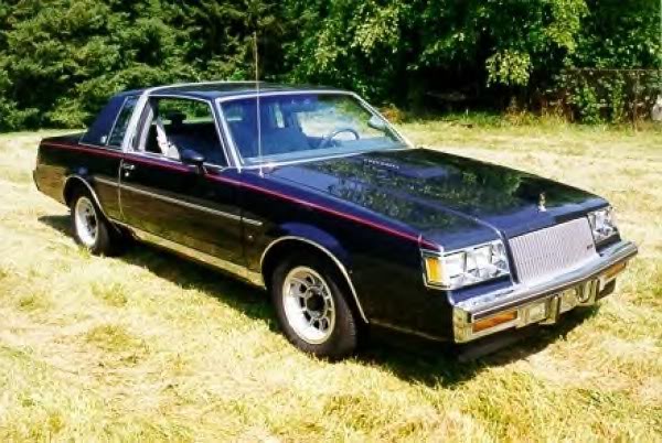

I want it to eventually look like this:
Attachment 819
