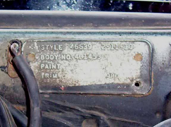

buickluva 04-26-2008 09:32 PM
1 Attachment(s)
hi man, open ur hood an look on the firewall behind ur engine, far right side..usualy just to the left of the wiper motors on the old buicks there should be a model plate with a series number on it..46200+ was a regular..46400+ was a deluxe and 46600+ was a custome..good lookin dude:)
looks like this man, this one here is for a custom wildcat in 65:)
Attachment 812Edited by: buickluva
