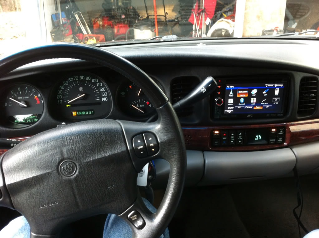

Installed JVC KW-AV60bt in my 2004 Lesabre Limited. Managed to Retained all OEM functions. Took a lot of money/time & research getting all the adapters needed but I now have a fully functional aftermarket stereo.
Onstar (analog system & doesn't work anyway)
Warning chimes
Steering wheel controls.
Retained accessory power.
Everything working with new stereo!
Attachment 690
Attachment 691
The head unit is a JVC KW-AV60bt
Pyle PLCM18BC License Plate Mount camera
JVC KS-U30 USB Video Cable for iPhone (needed for GPS function)
Metra Axxess ASWC Universal Steering Wheel Control Interface
Axxess - GMOS-05 dock & lock interface w/OnStar,chime & r.a.p.
Total cost so far around $837.00
